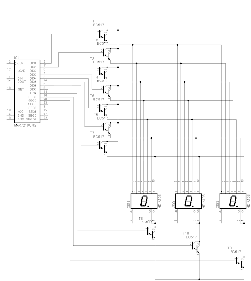

How about this then?
It inverts the logic but that doesn't matter. Off the top of my head mind, I haven't tried it but it should work, write high from Arduino and the 2803 shorts across the segment thus turning it off. Write low and 2803 turns off and the segment lights via the resistor.

Actually why bother, just use three TPIC68595s (high-current version of the 595 SR) and don't mux, three pins, three chips and you're done, or are you short of board space (unlikely with those huge displays).

Previously had thought of using individual darlingtons:
(Ignore that they are the wrong displays and that I haven't put any resistors in place and they are the wrong model of transistor, this was just to get an overview of the result, not the finished product :))
