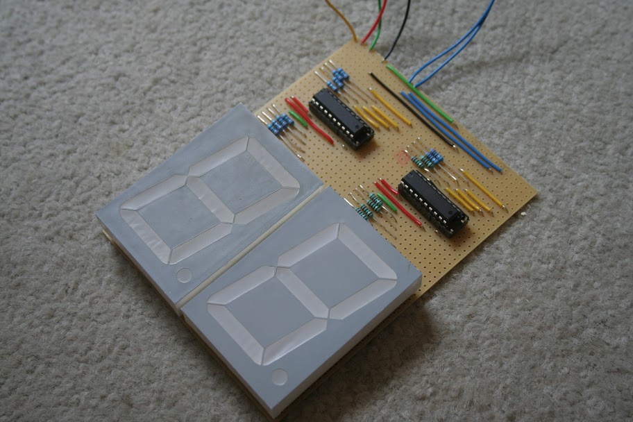

Okay so have everything wired up and it is working - sort of.
I seem to be getting a 'shadowing' across the displays. The following should be displaying 230:
And it is, however it also seems to be showing the previous digits as well. The camera doesn't pick up the light differences too well. You can see that there is a 230 displayed as they are brighter. The remaining LEDs are at about 25-50% brightness.
As far as I can figure this is an issue with the way that I am using the shift registers with a common cathode display, as suggested by Graynomad. I can't use the G line to blank the display while updating (if G goes high to blank the display all the outputs switch off thus actually turning on all the LEDs), so you are seeing the effect of the other numbers being pushed down the shift registers.
The only other way I can think of is to cut power to the GND of the displays as the screen updates using a transistor. I was hoping though that someone else may have an alternative solution that could be applied in software.
For those interested here is a picture of the minute board:

Solved the ghost problem. Have put a transistor into the ground line for the displays. Now the Adruino can turn off the displays while it updates. Only downside is a reduction in brightness. Have to wait until tomorrow to see how that affects the readability in daylight.

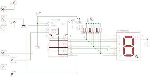

Here is the circuit diagram. Each display is the same.
Code (once I have it all working correctly I plan to tidy this up a lot, just want to fix one problem at a time). I borrowed the button check function for testing for a long press (sorry can't remember where on the web I found it  :-[). The clock came from Rob Faludi and his open source clock.

Got that, I'm about to have dinner but two things that look a little suss in the displayOut function are
Code:
 for(int c=0; c<=7; c++)
    digitalWrite(Tserial, bitRead(output, c));
    digitalWrite(Tclk, HIGH);
    digitalWrite(Tclk, LOW);
  digitalWrite(Trck, HIGH);
  digitalWrite(Trck, LOW);
Won't this produce 9 pulses on Trck?
and
Code:
 bitWrite(output, 6, secReg);
The DP is connected to bit 7, doesn't this set bit 6?
I'll have a closer look later tonight.

Trck is outside of the for loop so should only pulse once after each loop completion. Thinking about that, I should only need to toggle Trck at the end of the display run rather then after each loop.
Ignore the pins connections between the IC and LED. I had to adjust the pin connections on the breadboard to keep the wiring simple. Bit 6 is the DP on the prototype.
