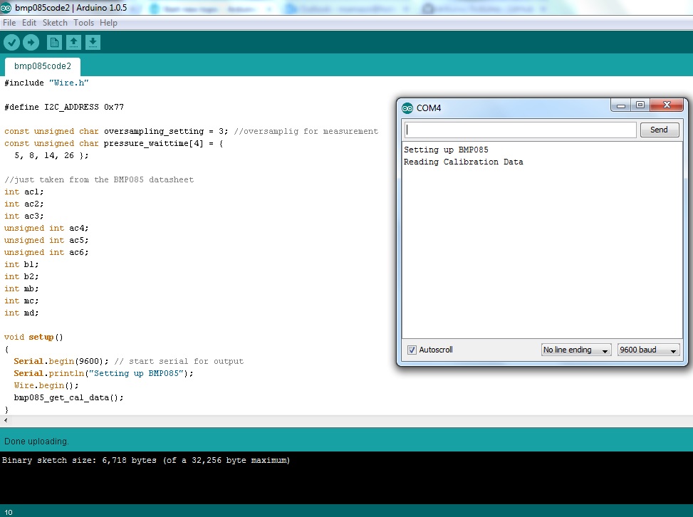

I have gotten the haarcascade issue fixed but now am left with the black screen issue.
Tested on processing 2 64 and 32 bit and same result. I tried the v1.5 and it had library issues so wrote that off.
Screenshot included....
