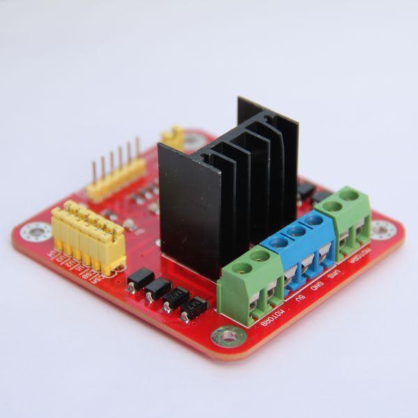

I'm building an autonomous rover (i know, how creative!). My electronics knowledge is quite poor, so i'm almost certain the problem is with my wiring. I'm just hoping i haven't blown something up.
I'm using this motor driver/controller circuit:
http://www.ebay.com/itm/200659789109?ssPageName=STRK:MEWAX:IT&_trksid=p3984.m1423.l2649
To power these motors:
http://www.ebay.com/itm/4WD-Robot-Smart-Car-Chassis-Kits-car-with-Speed-Encoder-DC-3v-5V-6V-for-Arduino-/171122633517?pt=LH_DefaultDomain_0&hash=item27d7b42b2d
I've got 471pF ceramic caps across the leads of each DC motor. I was advised to do this to reduce the jerky-motion of the motors. (How accurate was this advice?)
and an Arduino UNO R3.
I realised that the motor controller that i had purchased only supported upto 2 DC motors, so i connected the two LEFT motors in parallel and the same on the RIGHT. I ran the two leads of each motor setup into the MOTORA and MOTORB inputs of the motor controller.
I decided to power the motor controller circuit (VMS) with a 9V battery and the GND to the -ve obviously. The 5V in was left empty. The ENA and ENB are connected to the PWMs of the Arduino Uno and the IN1,IN2,IN3,IN4 are connected to DIGITAL pins of the Arduino.
On the Arduino-end, i've got a 9V battery with a 2.1mm plug to supply power, and i created a common ground between the Arduino and the Motor Controller by connecting the GND pin on the Arduino to the GND of the Motor Controller on a mini breadboard (Am i doing this right?).
And i'm using the 5V from the arduino to power the Servo and the Ping(ultrasonic) sensor, with both their ground wires connected to the common ground at the breadboard.
I tried to run a small test code to see if the motors are working, but they don't seem to be:

I used a multimeter across the DC motors while the code was running and i would get about 0.4V to -0.4V when the above code was executed. So i'm assuming that the motors aren't receiving enough power?
Any help would be appreciated,
Thanks in advance

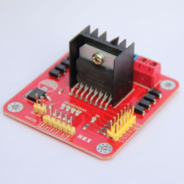

I connected the arduino 5V to the L298N 5V and ran this code:

The motors are receiving more power (about 1V) , but still not enough to move. They start to rotate slowly if i give them a push, so i'm starting to believe it's a power issue. But i assumed the 9V battery would be enough to power them (I'm using two of these - one to power the arduino and one to power the motors via the motor controller [vms] : http://3d4me.files.wordpress.com/2009/02/9v-battery.jpg).
This is what i was told regarding the 5V_EN:
Quote
The 5V_EN jumper enables the onboard 5V regulator. If EnA and|or EnB are left floating it will enable bridge A and|or B. To disable, EnA and|or EnB should be put to 0v. The CSA and CSB are current sense pins and are used to sense the motor current. So if you're not using current sense, leave them jumpered to the ground
As of now, the 5V_EN and all the CSA/CSB/U1/U2/U3/U4 are jumpered to the ground.

A 298 chip loses a minimum of 2v between input and output (1.8 in fact), and if you look at the datasheet (2nd last line on page 3) you'll see that can rise to almost 5v under high current. With your motors doubled up, you could be drawing quite a high current and be incurring quite a voltage drop. That wouldn't explain the drop right down to 1v though, but as pointed out those 9v batteries are not renowned for their longevity.

dc42
I agree, it's a combination of voltage drop in the L298N and the 9V battery not being able to supply enough current. You need to:
1. Replace the 9V battery by something more powerful. You could use a bank of AA alkaline or NiMH cells, or a LIPO.
2. Preferably, instead of the L298N use a modern mosfet-based motor driver, such as this http://www.pololu.com/catalog/product/1213. This will reduce the voltage drop to a small fraction of a volt.

Thanks guys! I finally managed to get the wheels moving - all i needed was more current. I added a 4 AA Duracells in parallel with the 9V and it's working fine. I'm going to try pick up a 11-12V LiPO if i can get my hands on one. It's almost impossible to find one locally.
