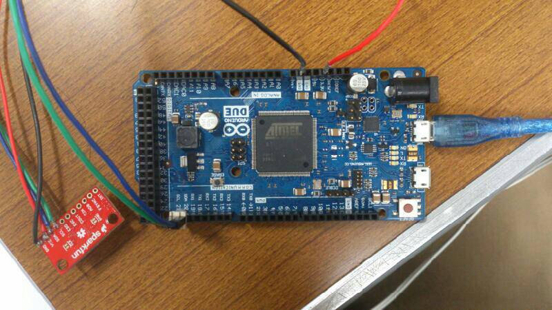

I wrote a program for reading date from MPU9150 based on UNO and everything was fine.
Recently I use DUE with the same program, but I receive nothing..
I don't where the problem is, could anyone help me?

chriskner
bf9456,
Wire.endTransmission(False) is the problem.  It's different for the DUE (in its current form).
Search this forum for these issues.
Be prepared to do some coding...
-Chris
Litchfield
The problem is that the Due Wire library (1.5.4R2) does not support repeated starts. As stated by chriskner, the Due Wire library ignores the false in Wire.endTransmission(False) statement. In the UNO, MEGA and other 8 bits AVR MCU's, a repeated start was fudged by doing an incomplete write (without the stop) and then immediately doing a read. In the ARM based AVRs this is not possible as a write will never complete without its stop. Fortunately the underlying Atmel SAM TWI library that is used by Wire does support repeated starts. It requires the addition of a new function to the Wire library , Wire.cpp, to expose the underlying TWI function and its function prototype in Wire.h.
The Wire.cpp and Wire.h Wire are located at:
...\arduino-1.5.4-r2-windows\arduino-1.5.4\hardware\arduino\sam\libraries\Wire\
Add to Wire.cpp:
Code: [Select]
// Added function to provide repeated starts
uint8_t TwoWire::requestFrom(uint8_t address, uint8_t quantity, uint8_t reg_address, uint8_t reg_address_length) {
if (quantity > BUFFER_LENGTH)
quantity = BUFFER_LENGTH;
// perform blocking read into buffer
int readed = 0;
    TWI_StartRead(twi, address, reg_address, reg_address_length);  // request register and read
do {
// Stop condition must be set during the reception of last byte
if (readed + 1 == quantity)
TWI_SendSTOPCondition( twi);
TWI_WaitByteReceived(twi, RECV_TIMEOUT);
rxBuffer[readed++] = TWI_ReadByte(twi);
} while (readed < quantity);
TWI_WaitTransferComplete(twi, RECV_TIMEOUT);
// set rx buffer iterator vars
rxBufferIndex = 0;
rxBufferLength = readed;
return readed;
Add to Wire.h:
Code: [Select]
uint8_t requestFrom(uint8_t , uint8_t , uint8_t , uint8_t); // allow repeated starts and multi-byte reg addresses
To use the new function replace:
Code: [Select]
Wire.beginTransmission(MPU9150_AD0);
  n = Wire.write(reg_first_addr);     if (n != 1)  return (-10);
  n = Wire.endTransmission(false);    if (n != 0)  return (n);
  Wire.requestFrom(MPU9150_AD0, size, true);  // Third parameter is true: relase I2C-bus after data is read.
with:
Code: [Select]
Wire.requestFrom(MPU9150_AD0, size, reg_first_addr ,1);
The last function parameter allows multi-byte register addresses, in most cases it will be set to 1.
