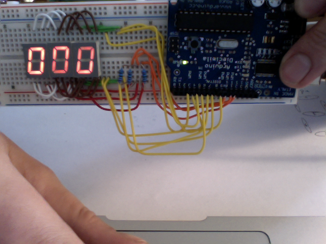

ok, now that I / we have gotten this to work, i want to add another digit. i will clean up the breadboard, pins allocations, code and the fritzing diagram.
wiring:
code:
Code:

its working!!!...
to the human eye it looks perfectly fine,
but as you can see in the picture --and told me already -- the segments vary in intensity. i assume that the resistors are at the wrong place.
... and off to the next problem. this is so much fun.
if i m gonna make this happen properly, i could make a tutorial for newbies out of this thread.
« Last Edit: September 15, 2010, 09:25:34 am by betweennullandone » Logged

Quote
I notice that you only have one resistor limiting the current for each display. This is very bad and means that the segments will vary in brightness depending on how many segments are on. There should be a resistor in line with each of the segments and no resistor in the common line.
how am i going to fit all the resistors on the board?
what is the correct way of doing this?
can i just switch the resistors? meaning: putting resisors on each pin,
and leave them out on the ground pins?
thx
« Last Edit: September 15, 2010, 08:37:37 am by betweennullandone » Logged

Quote
Yes you can. Each of the 7 segment pins should have a resistor of it's own. That's one per pin not one per segment as you connect 2 or 3 segments to one pin.
But then you run into another problem. The cathode pins will not be able to sink the current from all the LED segments when they are all on. The pin (all pins on this processor) has a current limit of 40mA. Any more and you damage it.
You can limit the current through the LED to one eighth of the maximum that is 5mA or 700R.
The real solution is to drive the pin through a transistor (then writing high will mean on and low will mean off).
