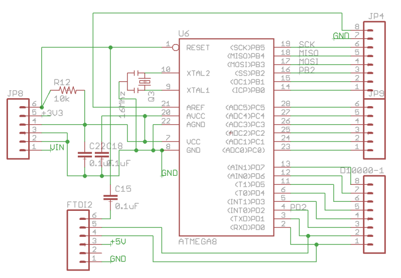

ill_switch
Lotsa 100nF decoupling caps in my design - one on every Vdd/Vss pair, and they're right next to the pins, so it should be "best case."
Can someone suggest the next step to take for troubleshooting? It SEEMS to me like the Arduino is in fact attempting to communicate with the ENC, based on the stuff I probed back in my last few posts. Assuming those results look OK, how can I proceed to test if the ENC is getting initialized correctly? Is there a simple way to get it to respond back to the Arduino, or code I can add that will let me know that the Arduino and the ENC are, in fact, communicating?
At the very least I know the sketch is running and the RESET on the AVR is working, as I've got an LED wired on a digital pin and inserted code into the ping example sketch to get it to blink at different speeds in setup() and loop().

ill_switch
#23
Aug 24, 2010, 06:04 pm Last Edit: Aug 24, 2010, 06:05 pm by ill_switch Reason: 1
Sure. There's a lot in this design not related to Ethernet functionality so in the interest of simplicity I'm only posting the section of the schematic showing the ENC28J60 and the AVR running the sketch. I'm 99.999% sure the problem isn't elsewhere in the design (i.e. something else causing interference), as I've tested with and without the rest of the PCB.
Here is the ENC28J60, magnetics, level shifting, and 3v3 supply:
Here is the AVR (there's a standard 7805 supplying 5v):
guinnessimo
ill_switch,
Your circuit appears to be fine.
I use a 10uF electrolytic on Vcap and that works fine.  I notice that the decoupling on the 50R networks is 100nF.  Microchip datasheet suggests 10nF.
If the '328 is successfully initialising the ENC28J60 then it should flash the green and yellow LEDS twice after start up.
Check the continuity of SCK, SS  MISO and MOSI - it may be that you have a broken track and the SPI bus just is not fully connected.  As well as broken tracks - look for solder shorts or if it's a home made board - etching faults which might leave shorting slivers of copper between pins.
Check that the ENC28J60 is not being held in reset.
If your wiring is correct and intact then they should work with the original NuElectronics code.
Have you got anything else hanging on the SPI bus?  Unless you use a 74AHC125 tristate buffer in place of the 74XX08, then the MISO line will not be released and could cause something else to hang.
Possibly swap out the 74XX08, for a '125 and enable MISO with the SS line and see if that fixes it.
If all else fails, swap the ENC28J60 for a fresh one.
Sorry you've had so much grief with this - mine worked just fine on breadboard.
G

China Red
#28
Aug 25, 2010, 02:05 pm Last Edit: Aug 25, 2010, 02:17 pm by wellswang Reason: 1
Hi ill_switch,
I think your design is ok,
and 100nF for the decoupling on the 50R networks is fine, because I used also it in my home made board, and it works fine.
(I have 2 version of ENC28J60 datasheet.  one is Chinese version, in this version, it suggested to use 0.01uF capacitors. Another is English version, in this version, it suggested to use 0.1uF capacitors. )
I think you may check your board to confirm all units were soldered properly and there was no short curcuit in your board.
BTW, in ENC28J60 datasheet, it suggested to use 1% resistor for 2K3 resistior which attached from RBIAS pin to ground, and also for 49.9Rs. But you said your ENC28J60 could not be initialized sucessfully (the green/yellow LEDs would not blink during starting up...), so I think it's not the root cause...
BR,
Wells.
ill_switch
Quote
How exactly would I check this? The RESET line from the ENC is tied to the RESET line on the AVR. I can ground the line and the AVR resets properly. If I probe the RESET pin right on the ENC (or the AVR for that matter) it sits at 5v when the sketch is running. So I am assuming that the RESET line is working, but don't know for sure.
I even tested the LEDs on the magjack to make sure they weren't malfunctioning and they're fine.
Nothing else on the SPI bus in this design (all other peripherals are I2C).
I'm close to starting over with the circuit (on a breadboard or another unpopulated PCB).
