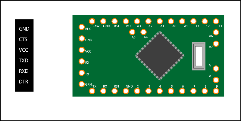

No I made a mistake and did not change the variables enough.  The light flashed on the MiniPro like it was trying to accept a new upload and went back to flashing.  I fooled myself into thinking it was fast slow fast slow.  As far as I know I have the right tool selections.  Mini Pro 5V, mega 328P.
Here is the board configuration I have on my mini.  I am not sure at all now what should be connected to what.  I am looking for any spec sheets I can for it but so far have not found any specific to this clone board.

Some things I learned when I was trying to do the same thing a while ago:
- RTS on the serial side gets connected to the RST (Reset) on the Pro Mini. On my USB converter this is up the side of the small PCB.
- In the Windows Device Manager for the COM port, go to the Advanced Setting tab and make sure that "Set RTS on Close" is checked.
For manual reset:
- Start the download from the IDE
- Hold down the reset on the Mini Pro
- When the Tx/Rx light on the USB converter blinks the first time, let the reset go.
The manual reset method works almost 100% of the time if you do it this way. The IDE will retry 3 times to establish connection and then give you the message you see.
I don't see a RTS on my FTDI Breakout board.
I tried the manual reset using the FTDI breakout board connected to the Mini Pro as-as (see below) with no success.  I the programmer is set on AVRISPmkII.  Is my my FTDI to Min Pro connection incorrect?  Should the RXD be connected to RX and TXD to TX?
FTDI-ProMini
GND-BLK
CTS-GND
VCC-VCC
TXD-RX
RXD-TX
DTR-GRN
marco_c
In my setup Rx to Rx and Tx to Tx. The pins are basically connected straight through from one board to the other (5V and GND included), but that clearly depends on the USB converter design.
