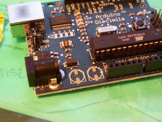

I took a look at pictures on the internet and noticed differences between my board and the other Diecimila board.
Why is it written Prototype Limited Edition on my board ?
Why is it missing one of the 25 Volts capacitor ?
Here is a picture of my Arduino Diecimila board:
http://upload.wikimedia.org/wikipedia/en/1/17/Arduino_Diecimila.jpg
Thank you !

I think that's the last prototype before the production run. You are missing one of the capacitors. It looks like it snapped off, as you can sort of see the SMt pin mark in the solder.

ATH500, look at the positive side, you might be owning a piece of Arduino history!  And if you don't use the external power supply, then the capacitor is not needed.

Do you think it's so bad to have a missing capacitor on my board ? Even if I used external  power source my Arduino seems to work with no noticeable problem, maybe it's because I am not using all the inputs and outputs on my board.
There is still one 25Volts capacitor on my board, maybe this one is doing the job, I don't know...
admin
Hello
You should be able to get a replacement board from the distributor
The capacitor obviously fell off during transport between them and you.
It happens sometimes with postal delivery.
the board would be working properly anyway for most of the applications even without that capacitor
(do get it replaced  anyway)

I have a customer who received an Arduino without capacitors also, and they were not in the bag. looking closely at the PCB you can see the the parts were never placed rather than broken off
ATH500
So, there must have been a flaw that happened in the surface-mounting process of those electrolytic capacitors.

Just an update to tell you that I sent my Arduino back to RobotShop Tuesday and received a new one Friday, it has both capacitors, yay!
