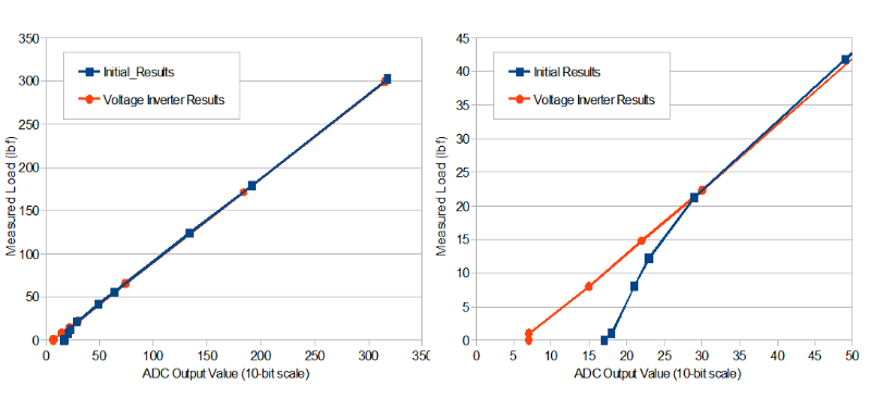

I finally got the nerve to go back into the hardware and try this fix.  I'd already mocked this up on a prototype board, so I had to move some stuff around (painfully, hehe).  It works!  Here is a comparison of before and after:
So it seems like it fixed the non-linearity down low, though there is still a bit of an offset which will be much easier to correct in software.  That must be the input voltage offset referred to in the spec sheet.  My concern now is that it might exhibit the same non-linearity in the upper range near the maximum output voltage of the i-amp.  I'm driving the ina125p with a 3.3V source (well 3.3V to -3V now) and I'm comparing my output signal against a 3.3V AREF.  The maximum loss of voltage up top should be around -0.8V as stated in the spec sheet.  This translates into 2.5V which would be around a 750lb load given the current gain setting on the i-amp.  750lb is plenty for my purpose, but if it exhibits non-linearity up high like it did down low then it might cause problems.  Unfortunately I have no method of measuring something this heavy, so I'm going to have to wait until the summer to test it.  :-)
Any idea if I would see a non-linear approach of the output voltage to 2.5V (or whatever it is in my sample) or would it be like hitting a brick wall?  Would I be able to test it by increasing the gain and applying a smaller load to the load cell or would this fundamentally change the response of the i-amp?  I'm hoping for the brick wall!  And thanks for all the help so far, this forum has been a life saver.
This project is nearing completion and I plan to post once I finish.  I'm almost done on the software side, but I'm trying to implement a simple on-the-fly peak finding algorithm and starting to knock up against the limits of the atmega328.  Wish me luck!

Take a look at the bottom right hand figure on page 5 of the datasheet at http://www.ti.com/lit/ds/symlink/ina125.pdf. The dashed outline gives the linear operating region with a single +5V supply (as you had originally) and the solid outline gives the linear region with +/-5V supplies (which you almost have now).  The non-linearity you had before was because you were operating outside the bottom left corner of the dashed outline. At high loads, you need to make sure you are within the top right corner, which should be no problem.

Excellent, then if I'm reading that chart correctly even at my 750lb output voltage (assuming a linear scaling from 5V to 3.3V) I should still be within the linear range of the amplifier.
