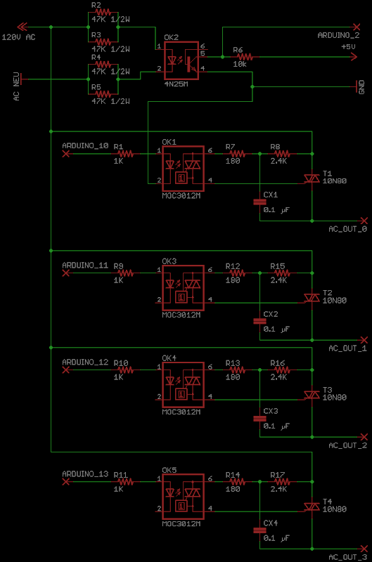

I am working on trying to get this whole dimmer thing going...  I got a Triac hooked up to control a light on one of the Digital IO pins. (and only killed one ATMEGA in the process!)
The problem I am having now is getting the Zero Cross detection working to be able to fire the Triac at the right time.  I have been looking at http://www.andrewkilpatrick.org/blog/?page_id=445 and http://www.hoelscher-hi.de/hendrik/english/dimmer.htm  which have been a great help.  Thanks Guys!
I have some H11AA1 and 4N25 optocouplers.  What was thinking was to have the HOT 120 V AC go through 25ohm 1 W resistor (right now 4 100ohm 1/8w in parallel to test it out) to pin 1 of the H11AA1 and Pin 2 to AC neutral.  Then pin 4 to GND and Pin 5 as an input with a 10K pullup to 5V.
But...  its not working, and I think I might of fried the coupler.  Any ideas?  unfortunately I do not have a oscilloscope handy   smiley-sad
Thanks for any help you can give, I love learning this stuff.

I think you missed the "K" in the resistance stated in Andrew Kilpatrick's circuit. He has two 47K ohm resistors in parallel( 23.5Kohm equiv ) and not 25 ohm.  Try 4 100K ohm resistors in parallel.

Stupid me!  I just want to CrapShack and got some 1/2W 47K and it seems to be working now...  I will post the code when I am done to show how it is working.

Also, here is an updated schematic, I changed some resistor values, and am going to go try them now.  (I only have one of the AC Triacs hooked up).
I'll post some updated code soon.

Ryan, what software are you using to draw your schematic?  Just out of interest.

Eagle.  http://www.cadsoft.de/index.htm
I'm using the freeware version right now.
Also, SparkFun http://www.sparkfun.com/commerce/tutorials.php has some good tutorials on Eagle
