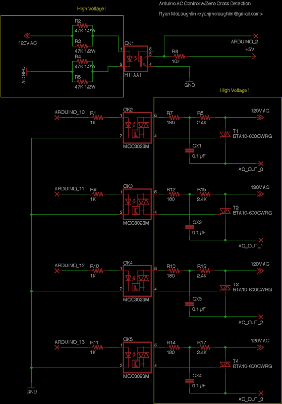

Hi,  Here is the current schematic.  There is a bit of leway in what triac and opto-triac coupler you can use.  Each output is for 10A, so I would not put more than 2-4A on each output maybe 600W, plus remember to keep wire gage in mind!
The "AC_out" should be connected to the "hot" of the load and the neutral of the load connected to ac neutral.
If there is enough interest I might make a PCB and sell a kit with 4 outputs.

Great work - but some questions...
I have been looking around over at http://diylightanimation.com/ thinking about next Christmas and Blinky lights on my house. Being an Arduino guy I wanted see what was possible using it.  Your post is a godsend.
The sample code you posted uses a delay and one output - but your schematic shows 4 triacs.  Do you use a if/else string to test some current counter to decide if one or the other Triac needs to be turned on?  Like setting one of the timer's up to decrement a variable and test it in a series of if/else in the main loop?
In any event your example is quite a great start at what I want to do - which is something like the SSR4 @  http://diylightanimation.com/wiki/index.php?title=Equipment

right now I only have dimming hooked up on one channel. Fir what I am working on I only need one channel to dim and 3 just on off so this will work great. My thought to do all 4 would be to do the math for the dim time in the main program. You would need to figure out which channel to dim first and do the additional delays after that.  It would take some playing around with.
I did some more debugging on the code yesterday and will post the changes. The only problem I am still havving is speed. It seems that the delays are consuming all my program time and I cannot get the dimming process to run in the "background"

Hi folks
I really love your project Ryan!
I was just wondering if some of you may know if this circuit will work with the Norwegian power supply (230 VAC, 2 Phase, 2 hot wires, no neutral ). At least I think that is what we are using[ch8230] =).  If not, does anyone know what has to be changed in the circuit to make it work?
Really appreciate your help people, and maybe someday I will be able to help you with your problems. (I am more of a software guy).

The triad control can work with 230, although I have not tested it. You may need to change some of the resistor values to optimize it.
The only thing I am not sure about is the ZC detection. It should be ok but would need to be tested.

To AdaRma
I am pretty sure the mains in Norway is similar to the Danish net. Which means that the voltage is 230 V all right but with only one hot pole (Phase). The other i 0V (zero) which is not ground!
Energy consuming machines like ovens etc. may use what we in Danish call "Kraft" which is two hot wires (phases each 230V from zero, but the sine-wave phase is a bit different, so the resulting difference between the two phases is 380 V)
This is however only awailable in special outlets. The usual wall outlets only contain one phase and zero.
The circuit should be the same, only the voltage dividing resistors should be recalculated.
I plan on doing something similar soon that is to be used on 230V. I will post my circuit when it is worked out. Probably next week or two.
Hilsen Niels

FWIW - I got some parts, finally, and am going to put this all together.  I even found someone with a very old scope, maybe there will be some waveforms for you to see.
Something else I have observed is that the opto only interrupts on the rising edge of the positive half of the mains swing.  If you trigger the triac during that phase, it will turn off as the wave goes negative and everything will wait until the net positive excursion of the mains. So at most you will only get 50% brightness.
Or am I missing something critical?  A lot of the app notes I see out there use a full wave bridge in front of the opto so it sees only positive swings.

I think I will try something like that. The problem I was finding is that if you do not reset the timer after every zero cross any timing error will begin to accumulate and even after a few seconds your dimming might not work anymore.
As far as the opto...  I need to update the schematic. Use a H11AA1 not a 4N25. Using this you will get the "pulse" I described before at every zero cross.

Also, here is the update to the schematic...
I am going to try to do the code to Dim all four channels, and maybe even get a PCB draw up to make an Arduino Shield for this.
