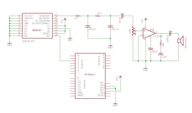

schematic -

Are you trying to skip the pesky 3 capacitors, two resistors just after pin 18, "VoiceOut"?
Bad idea.
But, as explained in the link given, if you want to use a simple "speaker" (WITH AMP) system meant for a PC, then you should be fine if you connect that.
The imformation that you gave about your amp+speakers passing the "hum test" was encouraging.
Just replace everything to the right of the 10 uF cap (previous post) with your speakers+amp.
Be sure to connect the "other" side of speakers+amp to Arduino ground. Be sure any electrolytic caps are plugged in the right way around.

Yarrrrgh, still nothing. Everything is seemingly in place...and yes, I've connected the three capacitors and 27 k resistors. I've got the audio out connected to this Vellman 30 W stereo amp (http://www.parts-express.com/pe/showdetl.cfm?Partnumber=320-212), which is grounded to the arduino and connected to an external 12 v AC power supply. The amp is working fine...picking up major radio interference...
in the schematic above, the electrolytic capacitor is marked for the positive side towards the amp, correct? (am extreme newb at reading this stuff)
Yet still nothing when I upload the code from arduino onto the board. Is there a trigger or something to make this start, or should it just talk when I send this to arduino?

interesting, I see that in the speakjet user manual, the 10 uf capacitor is labeled as having the positive side towards the speakjet, but in the schematic above it's the other way around. maybe my capacitor is just fried.

After checking the audio path, it seems that I can't create a loud hum after the 10uF capacitor. When I run the program, I can actually hear a quiet 'on click' come from the speakers, and then hear it click off after about 5 seconds, the length of time it should take for it to say 'lets make robots'. I'm hoping this is because the capacitor got fried, and not because the Speakjet itself is!

Had hoped to solve by the 24th but it doesn't seem possible. I've been troubleshooting this over and over again and have ruled out every possible problem (and followed all advice given to me) and the only variable left is the speakjet itself. I'm asking for a refund and ordering a new one. Thanks for everyone's help...
