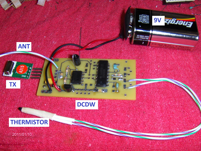

Circuit boards v0.1 and parts arrived, got 3 sensor nodes built except for the RF modules from SparkFun, which *finally* shipped.  So right now the DCDW prototypes are hardwired to Arduino Uno to support code development.
The initial "frequency counter" code hooks interrupt 0 on digital pin 2 and sets a flag then returns.  The freq measured by Arduino agrees pretty well with my scope.

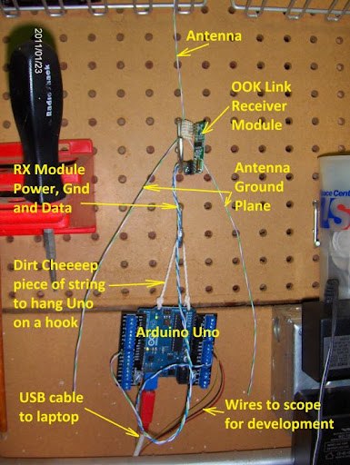

Received OOK radio links from SparkFun.  The interrupt driven software is pointless for OOK links, bkoz in absence of a TX signal the RX chases its detector right down into the thermal noise and the data out pin dithers randomly. Main Loop() ends up going off every time to countFrequency(), might as well code it that way instead of wasting an interrupt.  Also we can now use any Arduino data pin.
The good newz is the code reads the identical TX pulse rate thru the OOK radio link as it does hardwired.  This is bkoz the function countFrequency() measures time for 100 (or your number) of complete cycles instead of just measuring pulse width.

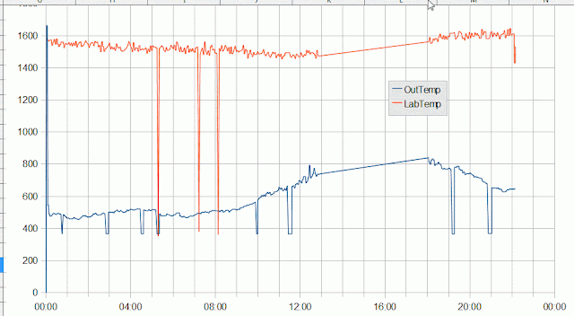

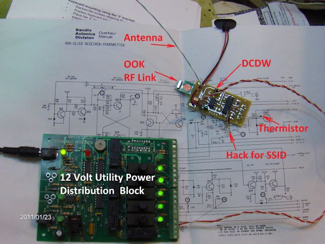

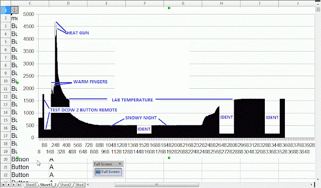

The function countFrequency() is now automatically immune to noise.  It also autoscales the sample time to the incoming pulse frequency and desired precision.  Code got fancier than planned but the use is simpler than before.
Heres a DCDW v0.1 set up as single channel temperature with identification:
Copied the Serial Monitor output to a spreadsheet.
Note in this TEST CODE the TIME IS NOT TO SCALE any valid samples are logged as they come in, when the SparkFun RX is just receiving noise, nothing is logged. Since function countFrequency() returns timely with error codes for noisy input you could plot whatever you want. Anyway this test code sampled between 1 and 3 seconds whenever valid data was present, no attempt *yet* to do real time, but thats where we are going.  You can see sample time automatically "shift gears" when temperature rose afetr bringin DCDW back inside warm lab.
Heres code. Function countFrequency() is much more advanced now. It returns quickly if no valid signal is received, and automatically stays gone just long enough to get ~3 digit precision.  The main code has some vestiges of 2-button remote version, and some declarations need to be hidden inside countFrequency() but its working well.

OK need some help here.
We have 2 DCDW in "single sensor plus ident" and a simple data logger to demo them.  Left it running to low inside and outside temperature for a day.  Problem is Win7 keeps turning off the Acer Aspire netbook.  Disabled WinDoze Update to prevent reboots, went to "power options" and set everything to "NEVER" (the netbook is on AC power adapter the whole time) but still I go down and find the DCDW happily chirping out temperature readins, the Arduino is receiving data (according to the LEDs) and trying to log to the stinkin' WinDoze that has turned itself off.
Where are all the OTHER power settings hidden?

Tonight status is :
Working on SSID (Single Sensor plus IDent, but thats easily confused with the WiFi term).  We currently have 2 problems.
(1) the CD 4093 Quad NAND with Schmitt Trigger Inputs produced by Texas Instruments is not acting like it has Schmitt trigger inputs. This makes the "gated oscillator" frequency chirp downward badly. Currently using slow packets of 10 sec every 3 minutes and the software can latch the data before the chirp becomes too bad.
Likely solution is avoiding this particular manufacturer for this chip
(2) when a collision of packets occurs, the software is sometimes does not recognize the error but rather mistakes the ID part of the second packet as the data part of the first one.  Over night this happened about 10 times in 500 sensor readings, or in other terms about half the packet collisions were erroneously accepted as valid data.  These are easily recognized as invalid readings but are still nuisances.
Solution is a more robust state machine, which is being tested overnight tonight.
Here is the master station
[glow]
When DCDW development is finished, only the l33t beta testers will have the genuine DCDW master station official mounting string.  Compatible with all genuine Arduino boards. Cost is just one carton of Samuel Adams for the development team! Supplies are limited, Sign up today!
[/glow]
Here is the indoor temperature sensor node
Here is the outdoor temperature sensor node
PCB layout v0.01 requires the ugly hack to scab on a diode, resistor and capacitor to put the DCDW in SSID mode.  This will be cleanly accommodated on all PCB versions going forward.
Here is a Open Office import of what the DCDW master received from its nodes
Long straight lines are  missing data when WinDoze7 ( >:(DONT get me STARTED >smiley-sad ) despite all power profile settings fell asleep and stopped listening to Arduino Uno.
Time is Arduino millis(), we have no Real Time Clock as you would use in a proper data logging project.  We also have made no effort yet to convert frequency (Y axis) backto temperature.  This is only a proof-of-concept for DCDW with one master node monitoring a swarm of sensors on a single channel.
The collisions are evident.  Most falsely accepted collisions the outdoor node was sending its ID and was interrupted by (much stronger) indoor node ID which was erroneously accepted as the data for the outdoor temperature.  Better spaghetti code software will fix this.  You software mugs will get a laugh out of this:
