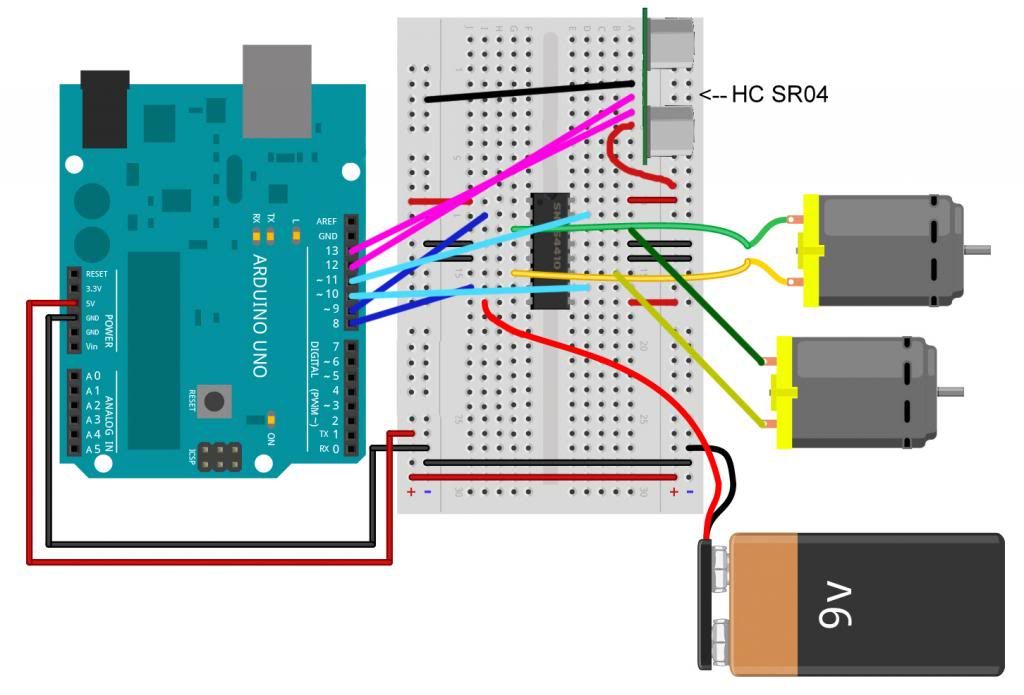

This is exactly how i built my circuit on my breadboard and this is the code used instead of the 9V battery I used 12V battery:

Your circuit is not wired per the datasheet. (see attached)
You have a motor connected 11 & 14

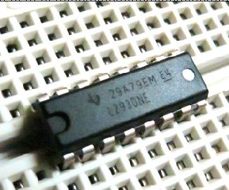

The chip in the Fritzing diagram is NOT an L293DNE.  Look at the number on the chip. Does that say L293DNE ?
Now I want the link where you got the wiring diagram for the circuit to begin with so we can find out what you did by using a wiring diagram for one chip and connecting for a different chip.
Look at the attached datasheet for the L293DNE.  Do you see a motor connected from pin-11 to pin-14 ?

Sorry I drew my schematic wrong. I've wired it properly. My IC is L293DNE. I've wired it accordingly to this tutorial :
http://itp.nyu.edu/physcomp/Labs/DCMotorControl
The only changes I made in mine was replacing the switch with the sensor and using pins 8,9,10,11 of Arduino for the motor control.
I referred this also:
http://www.instructables.com/id/Control-your-motors-with-L293D-and-Arduino/
These are pictures of my robot and circuit (without connecting the motors) :

Your schematic is wrong . (see attached datasheet-right half of page /DC MOTORS)
PINOUT
PIN#
1-PWM0B
2 M3A
3 MOTOR3-TERM-1
4 GND
5 GND
6 MOTOR3-TERM-2
7 M3B
8 VCC2-MOTOR POWER (+) LEAD /+ LEAD OF 47uF CAP
9 PWM0A
10 M4B
11 MOTOR4-TERM-1
12 GND
13 GND
14 MOTOR4-TERM-2
15 M4A
16 VCC1 -+5V /+ LEAD OF 100uFCAP
TEAR YOU CIRCUIT APART AND REWIRE IT LIKE THIS
POST A WIRING CHECKLIST THAT SHOWS YOU VERIFIED EVERY WIRE !

According to your schematic pin no. 1 and 2 of L293D is connected to PWM2A and PWM2B of arduino board, but according to the tutorials (previous 2 links I posted) both these pins are connected to +5 Vcc of the arduino boards.
By the way did you try out my code?
raschemmel
Quote
That's not what I see in the attached photos from the attached photos. Pin 1 (EN can be hardwired HIGH or s/w EN . Pin 2 should not be connected to +5V . See all the photos. Look at the code for the those programs (declarations)
Your schematic was clearly very wrong, most importantly because you had a motor connected to pin 2.
