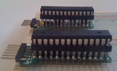

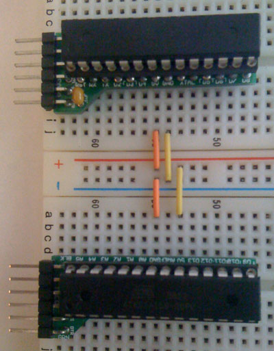

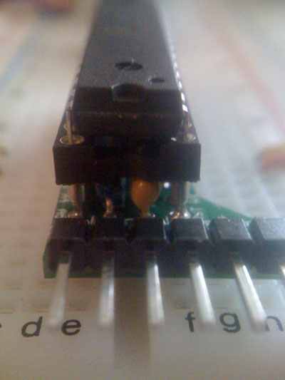

Small update to the mini version. I moved the reset capacitor under the chip, making the board that much smaller and look that much more like perf board. It's now quite possibly the smallest possible arduino board. Here are some pics, with comparisons to the previous version.

Hah, I actually designed one a while ago with the same formfactor, but I never had one made because I was more interested in breadboard-friendly designs. Mine also had a voltage regulator, which that one doesn't appear to. I don't see an eagle file or schematic for that one.
The SMD design obviously produces a thinner product, but the effective area of the circuit board is the same .64 square inches as my mini board, with approximately the same features (mine has a second led and an autoreset solder jumper, that one has a reset button). If it's a competition, I can move my solder jumper to a less accessible location and cut out the .02 square inch area that it's using smiley-razz

I think I can get this arduino down to the same footprint as the DIP row with some creative layout and tracing.

Not sure what you mean, I've already got it down to the dip footprint, plus a breakout for an ftdi header, which can't go under the chip for obvious reasons. I think the layout is already rather creative.
I've been working with the 168 for prototyping, but I can always drop in a 328 as a replacement

Sorry, didn't make myself clear.  I can reduce it to the same footprint using all SMT components where possible.   I think your DIP layout is absolutely brilliant.

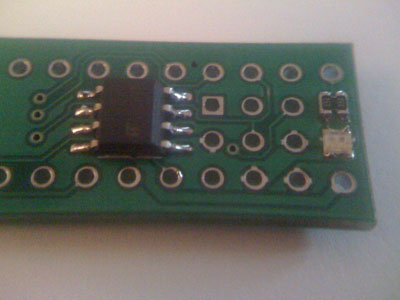

I'm working on redoing my SMT board with the pins in a DIP layout, and I'm also hoping to get the whole board down to the width of the usb connector. The routing has been giving me problems, but I designed an FTDI board today, and the process gave me some ideas for how to do the layout of the other one.

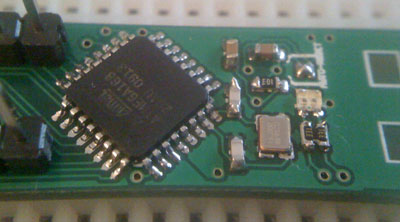

View Profile

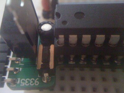

Minor update. This one was really just a test to make sure a crystal would fit, and now that I figured out where to put it, it fits even better than the resonator.
The next boards are already in production. They are rebuilt from the libraries up to be even smaller and more streamlined.

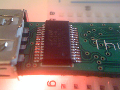

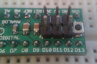

View Profile
Here are my newest boards. I finally got my "thumbduino" idea to work, and it's a pretty nice little board, if I do says so myself. The analog pin numbering is backwards and I've already fixed that and added markings to indicate PWM pins for the next round of boards. The redesigned wirewrap boards are .02 square inches smaller than the duinothumb.com "world's smallest" board.
