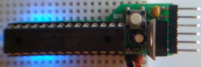

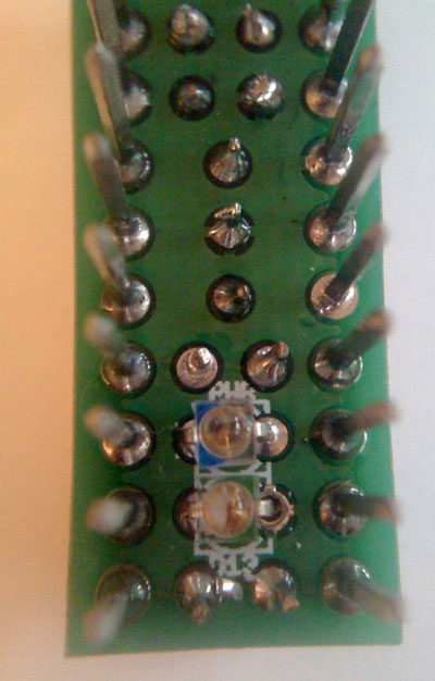

New picture time!
I've made some minor modifications since I ordered these, mostly playing with the fill geometry and silkscreens, and adding a solder jumper for disabling auto reset and an icsp header. The green LED is the standard D13 indicator. The blue one is a power indicator, but it uses D13 for a ground so that it's easier to discern whether the D13 led is on (they can't be on at the same time). The bottom fill is ground, the top one is +5V. The board is two inches long, and the ftdi header sticks out an additional 1/4 inch.
Oh, and any warping in the photos is a side effect of trying to avoid blurriness.

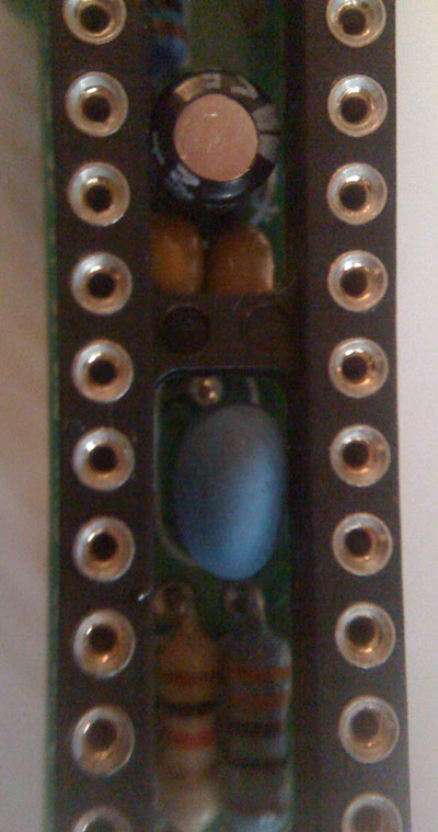

I love how you managed to fit a bunch of components under the socket.  Great use of space!

I rather like the idea of using a WW socket and putting components on the board UNDER the socket as well as using the socket pins themselves for plugging into the next "layer" of circuitry.

It's designed for a pretty specific list of parts. If you don't get the same ones, they likely won't fit, especially the caps and resonator under the chip, and the leds on the bottom of the board. Some of these clearances are less than a millimeter. I could give you a list of part numbers, but if I'm going to distribute the boards, distributing kits of parts to go with them will make things easier for everyone.

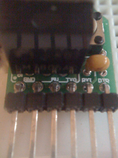

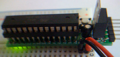

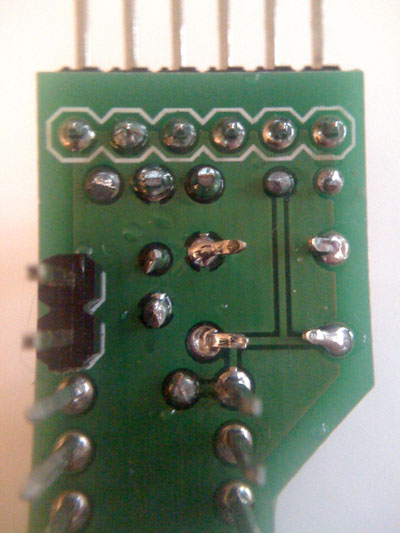

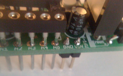

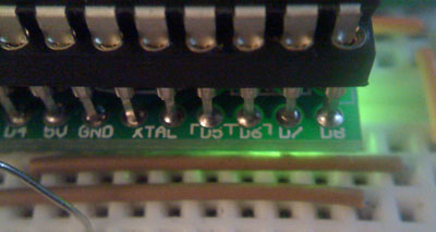

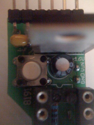

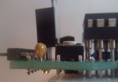

I got the extreme-closeup problem solved. Now you can see how bad my soldering is... and that I accidentally soldered the sockets in backwards. Here are a few more photos (I was having fun playing with my new toy):

Nice pictures.  I mean, not breathtakingly beautiful, but plenty good enough to show how things are set up, in ways that weren't obvious on the lesser closeups...  Useful!  Good work.
