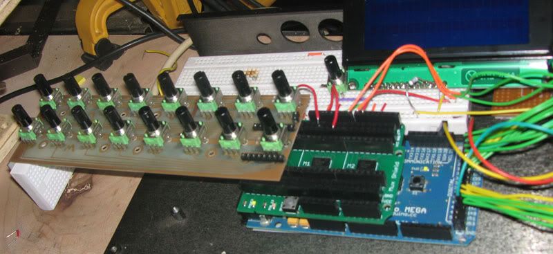

32 a/d inputs and linkable to have i believe a max of 256 inputs :)
problem I'm running into is Pots always have a value and it is hard to switch between sessions without messing your preset values up. so I came up with a better solution using rotary encoders and I2c
http://wtfmoogle.com/?page_id=398

I have received this shield, it is nicely designed in that the pins which are used do not interfere with the pins commonly used for LCD and serial. it seems perfectly well made with nice solder masking.
Delivery was very prompt!
I particularly like that the reset button and power LED have been brought up as well.
One problem I had is that the solder pins of some of the headers (MUX0, 0-3 and accompanying VCC) touch the USB housing on a duemilanove. i fixed it by filing the pins a bit so they are not pointy. it is still really close but they are not touching any more.
I am going to use it with 4 of the encoder sets from SURE electronics (which are debounced and made more easy to read with pics) for 16 inputs + buttons for a MIDI controller/sequencer.

MM, looks like a nice design. The only suggestion I would make is around your pin choice for controlling the board:
"Requires digital pins 2,3,4,5 and analog pins 0,1,2 - 48 inputs/outputs for the price of 7 pins"
Pins 2 and 3 are the optional two user interrupt pins on the standard 168/328 Arduino boards and would prevent the use of user interrupts while you board is functioning? Interrupt functions can be so very useful for some projects its unfortunate to not have access to them when using your shield when your shield does not actual utilize interrupts?
