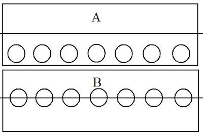

I am designing a PCB to incorporate POV with LEDs. My question is: do the LEDs have to be aligned with the radial line or can they be offsetted and still work? My suspection is not aligned version gives italic letters.
A) not aligned
B) Aligned

Well think of it as how they will appear when it is rotated.
On the radial line, they will be as they are and all the LEDs will pass the radial line at the same time. Therefore when all the LEDs are lit up, the line will be straight out from the center.
As, you offset the LEDs, either the first or last LED will reach the radial line first as it spins and if you all the LEDs were then lit up, you would get a diagonal line.
You could account for this in code though. If the offset is small then I doubt you would notice much. Most of the time POVs do not look perfect anyway due to differing LED brightness, slow code (which may give italics as it is) etc.
If you have to offset the LEDs then as you will be measuring the speed anyway (presumably) so you can calculate in code the delay you will need in between lighting each LED.
Well that really is long winded - I must be tired.
So... basically yes using code designed for centralised LEDs but no if you account for it in code.
Obviously the further out you put the LEDs, the larger the gap in the middle of the POV.
