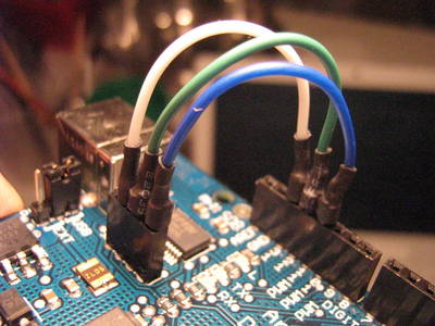

I tried your instructions yesterday since my Diecimila went dead (rapidly flashing LED L, bootloader not responding). Worked like charm! Thank you very much! I tried for hours to find a working solution for the FT232R bit-bang mode without success before coming across your page. Should definitely be mentioned on all the important Wiki pages.
I did it a bit differently that you suggest though: I soldered a female header into X3 so I can use the same cables I have anyway for working with Breaboards. The cables I connected to the 11-13 and RESET pins (reset pin is probably not really necessary since it's possible to use the auto-reset traces).
I had to call avrdude by hand though. Is there any documentation on the programmers.txt file? I couldn't figure out how to integrate the new programmer.
Thanks for the good work! Saved my day :-)
Greetings,
Sebastian
PS: I added a fourth wire to RESET after taking the picture:
