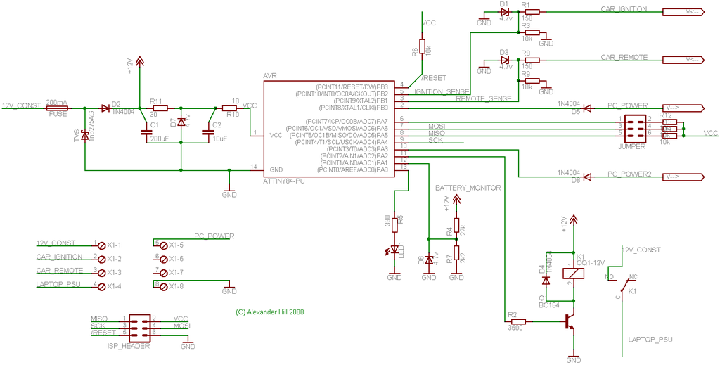

Alrighty,... trying to connect this thing up to the relay... heres what im thinking...
This is what the relay looks like:
- 1 (COM) connected to one side of the power switch
- 3 (NO) connected to the other side of the power switch
- 2 Connects to 5v line
- 5 connects to the Arduino digital pin out (5v)
Will the 3 (NO) have 5v coming out of it? If so, i need it to have 0v since its just triggering the power switch.

Quote
Pin 5 of the relay goes to the collector of the transistor, assuming you're following than plan.
Quote
The contacts are completely isolated from the 5V and ground of the Arduino.  So the only thing coming out of pin 3 will be whatever went in on pin 1, when the coil is energised.  When the coil is not energised, there will be nothing connected to pin 3 by the relay.

Alright, well this is how i wired it up (and it seems to work fine)
Code:
- 2 Connects to Ground
I also tried putting the resister and the TO-92 on the relay and it didn't seem to have enough volts coming from the chip (around 1v or less). So i don't know why it called for a 2k ohms resister into the TO-92. I had the resister going into the "B" and the "E" going to ground and the "C" going into number 5 on the relay.
Once i tool the resister and TO-92 out, it turned the relay on straight from the chip to number 5.
Here is the final schema the guy used (notice where he doesn't even use a relay to turn on the power switch:
Now i would like to hook the power up so i can turn the laptop's power on/off at will. Using the schema above, this is what i think i need?
Here's a drawing i made in order to hook up a pin to unlock a car door.
Here's the 12v relay i got for this job: http://www.components.omron.com/components/web/pdflib.nsf/0/7270ED3CFB55EBFF85257201007DD4FF/$file/G8QN_G8QW_0607.pdf
Its the G8QN-1C4 DC12
thanks,
David

I hooked it up like i have in the drawing but it doesnt seem to work..
When i ground it and supply the 12v to the 86/85 pins it opens up without it even having the 5v signal off of the chip? Once i add the 5v from the chip it still doesnt do anything... What did i connect wrong?
I used the following:
- NPN/25v/1.5a/120-200 small signal transistor
- 1k resistor
- 12v SPDT relay
- 1N4004 400v 1a standard rectifier
Thanks.

Ok, i drew what i currently have it hooked up like:

Any input on this, Anachrocomputer? Keeps staying open when i provide the 12v on the other side of the relay!
I'm simulating 5v coming from one of the digital pins. I'm getting about 0.76v from the base. I'm getting about 0.03v from the C when connected to the 12v as well.

Double check that your wiring is actually the same as the diagram. If it is and you get 12 volts on one side of the relay coil and 0.03v on the other then the relay is probably faulty or specified for a higher voltage.

Yeah i still get 0.03v on one side and 12v+ on the other. The relay requires 12v to open and that's what its doing... but its not doing it correctly.... It needs the 5v pin to trigger the other side of the 12v and right now, its opening when i supply one one side with 12v...

Alright, correction... its 4.62v when i DO NOT supply the 5v to the output pin and 0.03v when i DO supply the 5v....
