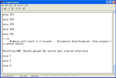

I may be jumping too early to get help here, but it may save me some hours (days?).
I am trying to follow Rob Faludi's course for programming arduino wirelessly, through XBee.
Here is the article:
http://www.faludi.com/itp_coursework/meshnetworking/XBee/XBee_program_Arduino_wireless.html
My 2 XBees are talking to each other fine (I checked).
All is good up to the point of (after) reset, when the bootloader is supposed to start loading the sketch. I see the (old) sketch starting very fast (less than 1 second) after the reset. The LED on pin 13 does a quick flash, then the sketch start to run. It seems that the bootloader never has the chance to read the serial port.
Arduino IDE reports error
Binary sketch size: 3328 bytes (of a 14336 byte maximum)
avrdude: stk500_getsync(): not in sync: resp=0x20
avrdude: stk500_disable(): protocol error, expect=0x14, resp=0x20
I had tried communication speeds of 19,200 (as in the article), for atmega 168, as well as 57,600, with atmega 328. Same behaviour in both cases, the old sketch is restarted right after reset.

This is how the hyperterminal session looks like:
I was wondering if anybody had any success with this method.
Could this be caused by the unorthodox reset (output pin 14 connected to reset pin)? The uC seems to properly reset though, the sketch is restarted fresh.
Any help is appreciated.

Thanks.
I did some more investigation and it seems to be unrelated to the "self reset" method.
When I (manually) press the reset button, I would expect the behaviour to be similar to a non-wireless board, that is, immediately after the reset, the bootloader should start reading the serial port for an upcoming sketch. That does not happen, I get the same error.
So, at this point, I am sure that the "self reset" is not the culprit here.
