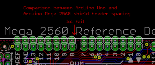

Also, the plot thickens...
There is no way those are going to line up, something is in the wrong place...
That shield lines up perfectly with both my Diecimila and Duemilanove, I haven't got the old mega, but I believe shields should be compatible regardless.
With some creative bending and soldering mine now lines up, but surely this isn't right.
Senso
The holes are pretty much mis-aligned.  :o

#24
Oct 01, 2010, 11:45 pm Last Edit: Oct 01, 2010, 11:48 pm by macegr Reason: 1
The mega2560 pin spacing IS actually different from standard Arduino spacing, in the Eagle file. It's a little bit closer as seen in beige's pic.

#25
Oct 02, 2010, 12:18 am Last Edit: Oct 02, 2010, 02:58 am by davekw7x Reason: 1
Quote
That spacing on the Eagle .brd file for the MEGA2560 is 150 mils (0.15 inch) rather than 160 mils (0.16 inch) of the other Arduino boards and shields.

The discrepency of 0.01 inch is equal to 0.254 mm.

Please, please fix it this time, and don't let the twice odd pin spacing become an Arduino Mega quirk/standard ;D
westfw
Quote
Huh.  The old mega has the same .15inch spacing as the Uno 2560 (both in the .BRD file and also on my real piece of hardware...)  (And no one has noticed till now?!)
