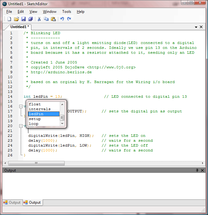

I've started a "small" project to build a sketch editor in c#. i will only work in Windows for now...
It's not ready yet for a download but i have some screenshots that i like to share with you.
I don't have much time for a project like this but I've managed to "convince" the company that i work for to sponsor it by letting me spend some hours a week in the project...  8-)
I will "opensource" it in the future... ( because of the sponsorship, some internal decisions have to be made...  smiley-wink )
So, here are the screenshots:
I'am trying to make some sort of autocomplete (intellisence)  :smiley
Can you give-me some opinions based on this (very very small amount of) information? smiley

intellisense is a fantastic feature!  the one that would put it over the top for me would be step-through debugging.  I can see all kinds of problems implementing that though.

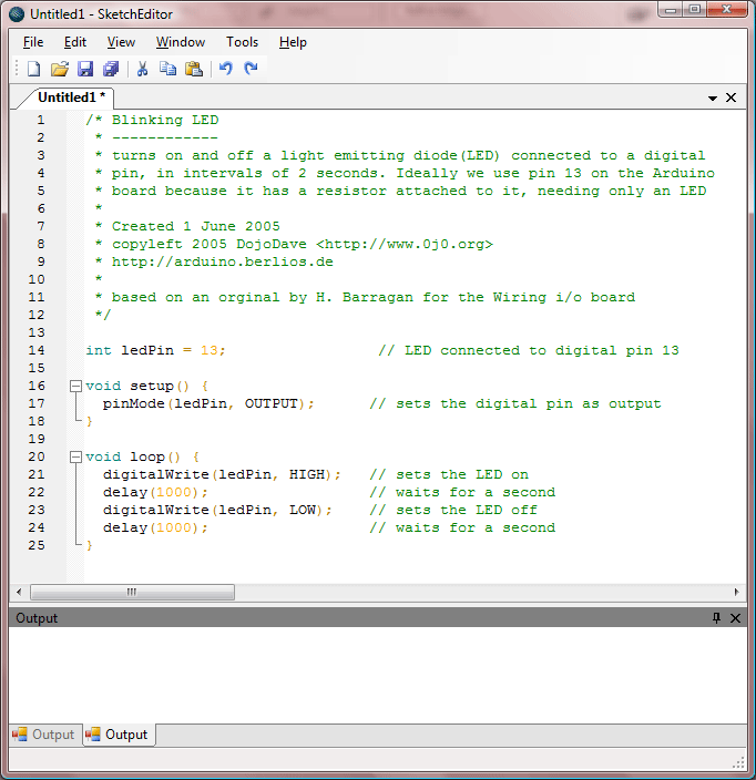

Just a screen shot of the current work.

The intellisense looks good.  My question would be about extra libraries or imported routines.  Does your code have some method to determine the correct syntax/options on imported libs?  Or if I have created a function in the same file and try to use that function, do the options come up?
Perhaps now is the time to talk about self-documenting code.  Where comments in the function are used by the editor to display 'sensed' options.
How did you implement the intellisense?  Is it hard coded into the program or is there a config file with all options?  When the arduino guys add a new command or function, how hard is it to add it to your library?
Also remember that the entire gcc library is available in an arduino sketch.

some replys:
harry:
yes thats a popup menu with suggestions for what you are trying to write
br3ttb:
i think that for step-through debugging i have some problems:
   1 - i may try and use an integration with gdb/Simulavr - i think Simulavr is outdated and updating it is not simple... (gdb with an emulator?)
   2 - writing a simulator from scratch is a very hard work...
   3 - Integration with the simulator in avr-studio? i don't know if the sdk from Atmel allows this... maybe i can try an contact Atmel on the subject and see if I can get any response...  ;D
   Can anyone help give some opinions about this?
   So, Maybe in the future step-through debugging will be possible...

Mark Bramwell:
I use ctags for parsing and generating information for intellisence from the libraries header files.
Because of scopes for the code being written in the current sketch (project) an internal parser is used. this is still being worked on
(ctags just reads globals, classes, etc...)
