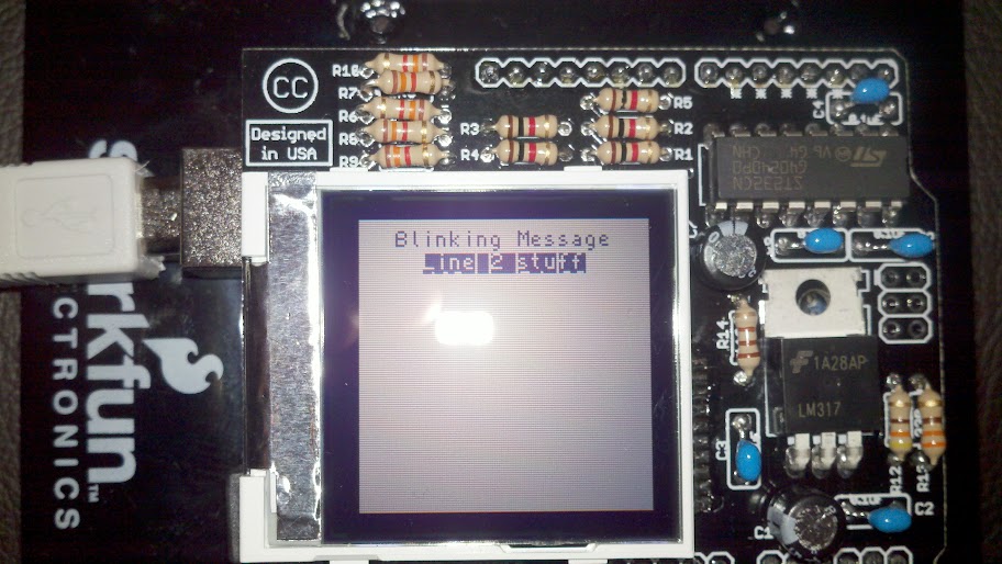

I just got an arduino (My first one so bear with me as I am new to this) and the LDS183.  With your code I've gotten it going with very little trouble.  Thank you for that!
I do have a couple of questions though
First when I display white text on a black background there appears to be white vertical lines  through the text 1 pixel wide (like the pipe charecter "|") at a couple of places making the text harder to read.  Is there a way to eliminate those lines?
Second, is there a way to make the text bigger?  If I need to I'm happy to do some reading or coding.  I just don't have a clue where to look.
Thanks again,
Loren

@Loren:
Can you post an image of the vertical bars, or post / send me your sketch?
It is possible to get bigger text, but it will involve a rather large modification to the code. You can take a look at my ITDB02_Graph libraries for ideas on how to do it. They both support small and large font.

Thanks For your help!
Here are a couple pictures:
And here is the code:

I have downloaded the graph code and will try and figure out the Large Font stuff.
Thank you again for your help.
Loren

I'll look into the problem, but it might take a couple of days...
/Hennning

RGB_GLCD v1.6 has been released
  • Fixed a bug in the print() function when using a background color different from the screen background color.
Any further updates to the library will only be announced on my website: http://www.henningkarlsen.com/electronics/
All site news is available as a RSS-feed.
@Loren: This new version should solve your problem with vertical lines smiley
/Henning
