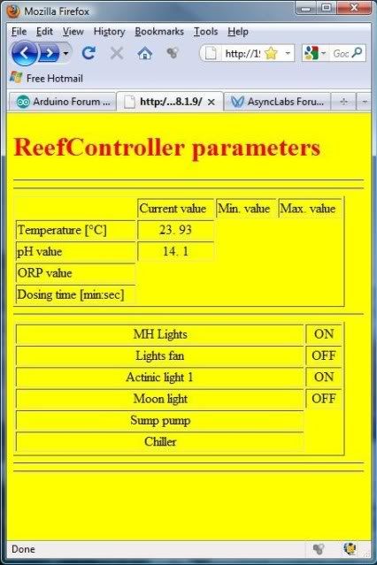

Why is this code in loop?
Code:
byte mac[] = { 0xDE, 0xAD, 0xBE, 0xEF, 0xFE, 0xED };
byte ip[] = { 192,168,1,3};
Server server(80);
During every execution of loop, you want to create a new server?
You would be doing yourself, and us, a huge favor if you were to learn to create functions.
Each case in loop should call a separate function.
Some indentation would be useful, too.
Code:
for (;;){
key = lcd.keypad();
if(key == -1){break;}
Magic numbers with no comments are to be avoided. What does the -1 from lcd.keypad() mean?
More code that does not belong in loop:
Code:
//******************************Web Server******************************
  Ethernet.begin(mac, ip);
  server.begin();
  Client client = server.available();
  if (client) {
You are restarting the server on every pass through loop. It's no wonder an external system can not connect to it.

With no thanks to a member's helpful post
Today I went back to the drawing board and after 9 straight hours have something to show for it
I even have managed to get the web page to refresh every 20 sec

I used meta......"client.print("<META HTTP-EQUIV=REFRESH content=20 url='http://192.168.1.9' >");"

don't know what you just said....but as you see it is how I entered it to the code
Code:
client.println("HTTP/1.1 200 OK");
client.println("Content-Type: text/html");
client.println();
client.println("<body style=background-color:yellow>");
client.println("<font color='red'><h1>ReefController parameters</h1></font>");
client.println("<hr/>");
