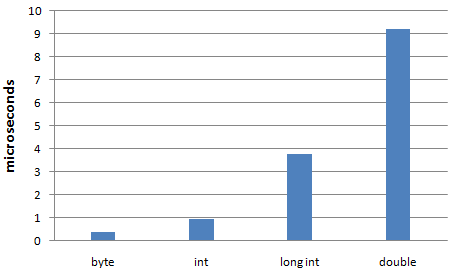

Was curious as to the speed of floating point operations on the 16MHz Arduino Diecimila. Could only find a few threads about that (e.g., http://www.arduino.cc/cgi-bin/yabb2/YaBB.pl?num=1206534749), with no answer, so I ran some tests. Here's a graph of results comparing the speed of a multiply operation using the various data types:
The way the C test program was set up, the values above include the time for the multiply operation as well as one memory read and one memory write.
These are the lengths of the data types in bytes:
byte 1
int 2
long int 4
double 4
I also looked at the time to do a sin() call to the math library: 255 microseconds!
Anyway, based on these results, looks like the Diecimila is about a 0.1 megaflop device, using 4-byte floats/doubles.

I must say I'm surprised it can do doubles so fast.  Do you have data for division?  With division algorithms, you'll need to test a wide range of denominators to get a good feel.
I just tried it with several different denominators & always get a result in the range of 34 microseconds. So floating point division is about 3-4 times slower than multiplication (9 usec).
Even so, that's about 30,000 divisions per second. This seems fast enough for (much) government work!  :smiley

Yep, on the AVR's, float and double are both 32 bits.

Confirmed, in winavr float == double (source: "WinAVR / gccavr does not support doubles, in other words: double is considered as float" in http://www.avrfreaks.net/wiki/index.php/Documentation:AVR_Float) and also from the maintainer of avr-libc: http://www.avrfreaks.net/index.php?module=PNphpBB2&file=viewtopic&t=50770&highlight=
