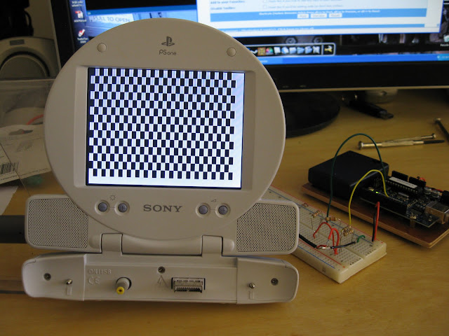

I figure the one thing that the arduino is missing is a display. I'm short on cash so buying a display was out of the question. But i do have a PSone with a 5" LCD. I did a little search online and found a previous attempt at composite video on the arduino in the forums.
http://www.arduino.cc/cgi-bin/yabb2/YaBB.pl?num=1166667354/0
But it seam there where still problems with it. I then found this site.
http://dailyduino.com/archives/368
So i figured i'd give it a try and see how it went.
I can't say i understand even half of the code but it does work... to an extent. Problem i'm having, and the problem presented in the thread, is getting the V sync worked out. It displays what its designed to say on the screen but its rolling from bottom to top.
Maybe someone wiser then I can figure out what could be changed to get this to sync up.

I've tried to change the #define _SYNC 0x00 value but it doesn't seam to change anything.  I'm pretty sure this is an issue with the hardware that we may not be able to overcome. But i sure do want to give it a try. This is a simple setup and could have allot of uses.
I think i'll start looking into the pin out of the playstation AV connection and see if i can go strait digital to the screen.

You may be having problems that this display is only 240 lines high.
US standard images are 262.5 lines per field (525 lines total), and whilst older analogue monitors will be OK with short fields, more modern digital sets may not be so forgiving.
(BTW, it isn't really composite, which combines luminance and chrominance into a single signal, it's just luminance)

Yes there are 525 scan lines on a TV of which only 486 are visible. So i have changed the number of scan lines to 243. I then went to the bottom of the code and played around with the ms delay in the last line and got a stable image with it set at 50 on this LCD. Though you can still see the scan line running threw the image. So there is still a bit of tweaking to be done. On a standard def CRT TV the image is still screwy. But i think once i get everything dialed in perfectly on the LCD that will be fixed as well.
I won't re post the code since the changes are simple. I may bring the scan lines up to 262 and see how it goes. The code errors out if i try and do a decimal place. But when i set the lines that high the image is blank.
EDIT: The best image i've been able to get so far on my LCD is using 100 in the last line of the code. But the timing is still off to propperly support a stable image on the CRT. Guess its time to move the arduino to the laptop so i can test it while on the TV.
BTW, if i get this all worked out, how hard will it be to have it coverted into a library?

Right now i'm at work so i'm unable to play with the settings right now. I wish i could get the IDE running on the PCs here. Then i'd bring my arduino with me and work on it more.
Though i have been reviewing the code and trying to get my head around all these timings. I have found a couple of lines in the code that are references to the original game this code was adapted from so i'll be removing those. Correct me if i'm wrong. As far as i can tell defining gray isn't needed at all. Either the areas specified will be black or white. Trying to do gray scale here would be too much for the arduino to handle.
I am considering redefining the size of the pixels. Since i'll have to redefine the number of scan lines to fit an NTSC display. Been trying to figure out how the width and height of the pixels first came to be. I figure with a NTSC display being 720x480 the width would need to be 40 and the height would have to be 15. Thats the only way to break it down into large pixels evenly. So each pixel the arduino will display will take up 48x32 block of pixels. The Display lines will remain at 240.
Current untested sketch. These changes have likely effected the timing.

can't help but wonder if this would be better suited on the analog pins.
« Last Edit: January 22, 2010, 06:29:20 pm by digimike » Logged
UK

I've come across some interesting findings trying to break down this code. I've got everything set to give a nice solid display on my LCD. Problem is the very top row, row 0 is displayed at the very bottom of the screen. Column 34 is off a bit in its width on the LCD but gets cut off at just the right size on the TV. Also on the TV we loose row 1. it gets cut off.
This project definitely needs a solid power source to the arduino. When using a battery pack of 4 AAA batteries that are a bit weak, the image isn't very solid on the LCD. The TV however is more forgiving here.
So as a reminder this is how you hook this up.
Code will be broken into 2 sections to fit in the limited post space.
Code:

« Last Edit: January 23, 2010, 01:54:07 pm by digimike » Logged

Here are the coordinates for the classic "HELLO WORLD"

I also updated the code in the above post. After creating Hello world i found that the pixel at (34,0) was not being cleared. I tried to fix the for() statement in the clearScreen section to wipe that pixel but it caused timing issues. So i added a line to clear that single area without effecting timings. For now that pixel isn't usable. Since its in the bottom right corner i'm not even going to bother trying to fix it. It can just stay off.

OK this has hit a dead end for me. Its just too much to try and get this to do anything. if you try to make it do more then show a single preset image your fighting timings. I've tried to take the original pong code, that this came from, and get it working on an NTSC display but timings are a nightmare. If you make a couple of small changes to the code you end up throwing everything off.
