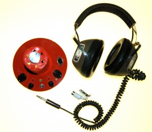

I put together an small midi-interface according to the notes in http://www.arduino.cc/playground/Main/MIDILibrary
The test program works, and now I wanted to use my midi keyboard to drive my Atari Punk Console
through midi. I successfully patched the APC through arduino, so I now what pins to change etc. The thing is:
It will only succeed once, then the program crashes. Also it won't work on the first try. I have to bash the keyboard till I get "lucky" and then it could be any key that would have worked.
basically I just set some analogue pins to make other sounds
