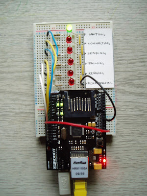

Here's the code I've been testing and my board - It's been very reliable and can survive disconnection of the Ethernet cable, router re-connect and also power disruption if you bend the pin out on the Ethernet board and connect one of the digital outputs to the reset pin. I used a piece of wire.
I've added a series of LEDs so I can see the system state when it's running from the power supply.

Here's a picture of my test board

Thanks a lot, neat set-up. Please beware that you are showing your api-key...

Oops! I removed the key - thanks. You should be able to convert the PUT to a GET easily enough
