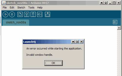

when i try to
1. start arduino 17
2. get the splash screen
3. then it freezes for 30sec
4. get message box
i think is has something to do with the rxtx,
this only happens after i  have a successful first connection with the arduino.
nothing but a restart will make it work again (once).
tried:
troubleshooting guide.
* no process 'LVPrcSrv.exe'. running
* no run.bat supplied with 17 on windows. asaik
* mybe it got something to do with "Why does do the Arduino software and the Tools menu take a long time to open"
java version "1.6.0_17"
Java(TM) SE Runtime Environment (build 1.6.0_17-b04)
Java HotSpot(TM) Client VM (build 14.3-b01, mixed mode, sharing)
windows xp sp3
*UPDATE*
well it was a collsion with nokia pc suite.
i disconnected the phone, which was identfied on COM3 using usbser_lowerfltj.sys driver, the arduino IDE works again.
