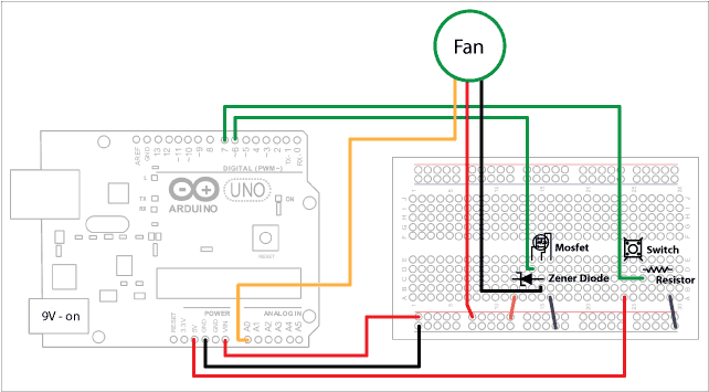

From Getting Started with Arduino, page 71, there is an image showing a method for turning on and off a motor. There is no arduino sketch included and no control switch, so I created a sketch using a 12V 40mm 3-pin computer fan, mosfet, zener diode, resistor, momentary switch and a 9V power source. I'm successful and turning the fan on and off, but am not sure what I'm seeing with regards to output from the yellow wire. When the fan is off, the reading from the analog 0 pin reads 1023. When the fan is on, I get a range of numbers between 0 and about 100, averaging somewhere around 9. These don't look like fan speed in RPM to me. (See example serial monitor listing, patch diagram and sketch below.) When I remove the patch wire between A0 and the yellow fan wire completely, I get analog numbers on the serial monitor averaging around 350, regardless of whether the fan is spinning or not. So I'm not sure what I'm seeing.
I suspect I need an actual sample method for A0, but am not sure where to begin, nor how to incorporate it with other commands that include delays within the loop. I would be grateful for some suggestions about how to measure the input from A0 so I can get a valid RPM on my fan.
Other thoughts:
I tried using pin ~10 in place of A0, but got the same numbers as A0 without patch cord.
Since the original exercise alluded to PWM for changing fan speed, I thought I'd try
   analogWrite(CONTROL, 128); // turn Fan ON
to get half speed, but ended up with a very high pitched whine emitting from the fan. It did spin at a visibly slower rate. I'm unsure as to whether continued use in this way could damage the motor or the board. I'd like to know one way or the other about this too.
Cheers

board patch diagram:
sketch:
