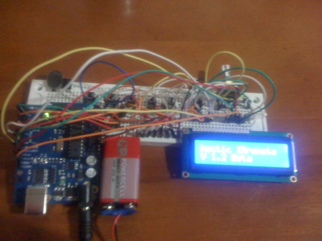

would a Picture of my breedboard/layout help???

ok here's some photo's sorry about my iphone its all i have to take a picture with at the moment
and this is what i what to do in the end
Cod modder/mapper
rotceh_dnih
mmmk i've spent manny hours on this and have managed to get it to work :)  :) :)
i only have 2 1k resisters so have only made it two buttons but more should work fine now :)
here's the code i got to work there's still some bug's like the channel button will still change between 1 two 3 channnel's not sure but maybe some debouceing code would help not sure

Korman
#24
Nov 06, 2010, 09:40 am Last Edit: Nov 06, 2010, 09:42 am by Korman Reason: 1
Quote
Congratulations. About not having enough resistors, this opens the venue to learn the next thing: Pull-up resistors. As the Arduino has integrated pull up resistors you can activate, you have the option to connect buttons without need of external resistors. Your code changes slightly but nothing impossible to handle in software.
For the hardware:
Connect your button between your Arduino digital pin and GND (not to +5V). When you press the button you're going to drag the votage down to 0 on the pin. No need for any resistors.
For the software, setting up the pin needs one additional line per pin.
Code: [Select]
pinMode(buttonPin, INPUT);
[glow]digitalWrite (buttonPin, HIGH);[/glow] // Activate internal pull-up
By setting the input pin to HIGH, the internal pull-up resistor is activated. Now if your button is open, the pin will read HIGH because a little current flows inside the Arduino to the input. When you press the button, the pin will be connected to the ground and you will read LOW. As the internal pull-up resistors are quite big (20kOhm if I remember correctly) there's very little current flowing.
The main difference between the regular button example and this one is:
digitalRead(buttonPin) == HIGH: Button is open
digitalRead(buttonPin) == LOW: Button is closed.
So in your code you have to change the line testing the button state to:
Code: [Select]
if (buttonState == [glow]LOW[/glow]) {
That's all there is. You just saved one resistor per button. Try it out.
Korman
rotceh_dnih
wow thank you very much that worked like a charm
but now im stuck at two button's i think it might have something todo with the "Else" command i put in as i dont understand programeing whatso ever im not sure but it is good to make progress :) :)

and a picture of my setup :)
