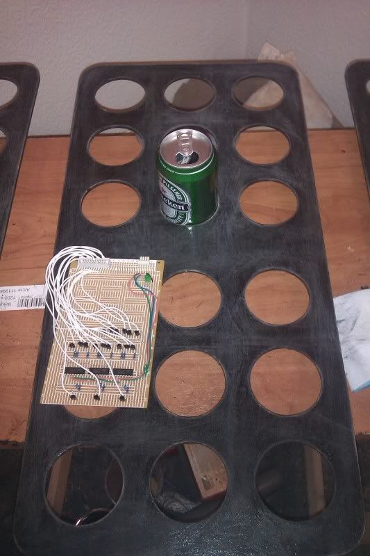

Slapped the first layer of paint on the stones and lightly sanded it:
And to put it into perspective, I added a beer can oh and the circuit boards are done (will post the circuit and code when it's working nicely):
Onto something more electrical than wood and paint smiley

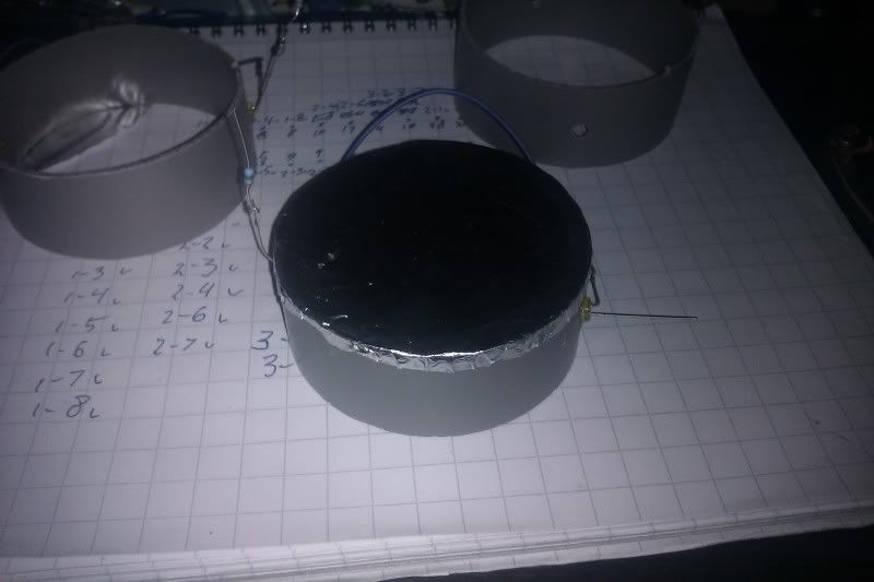

So I mounted the LEDs in short pieces of drain pipe:
And to close the back I used some aluminium foil (for our American buddies that is tin foil or aluminum foil smiley-wink ):
Looks like smooth sailing... well not really. The boards with the shift registers, in my finite wisdom I randomly wired the first one... doesn't sounds like a problem but with the whole dataArray stuff the all have to be wired exactly the same. Then there are the LEDs, the slight Dutchness inside me said: buy the cheapest, is best bro!! Now turns out is not best bro... They hardly give of any light, so had to order new bright ones. Either way progress is good, more updational goodness to come later today or tomorrow or whenever there is more to post.
