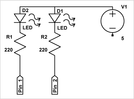

cr0sh,
Thanks for your reply.
Does the following circuit diagram come close to what you're suggesting for the eyephones?
As to the amplifier, I have a quad opamp. Could I use two subsets of pins from an opamp as easily as using two LM386's?

I've been looking around for "common cathode vs. common anode" information on LED's, and found that there is a much simpler way of approaching the use of my existing eyephones. This post on the adafruit forum was pretty insightful.
To that end, I set up a test sketch thus:
Code:
Sketch: Eyephone Test
Author: Chris Sparnicht - http://low.li
Date: 2011.01.31
License: Creative Commons 2.5 Attrib. & Share Alike
Description: A test for stereo led eye phones.
Notes:
  Common Anode Blink Test for existing LED Glasses
  Blinks two sets of LED's alternately in loop, using a common anode.
  When pins 5 and 6 are set to LOW, they emit light (on).
  When each pin is set to HIGH the no longer emit light (off).

I set up a double blink for the LED's on the right side just to confirm that the pin I'd specified was on the correct side. The fact that the left side LED's emit light during the double blink on the right side confirms that LOW means "On" and HIGH means "Off" with a common anode situation. Likewise, the analogWrite values are reverse as well. It looks like no transistors are necessary for this part of the programming. I may just need to inverse pin values in the sketch. Cool!
