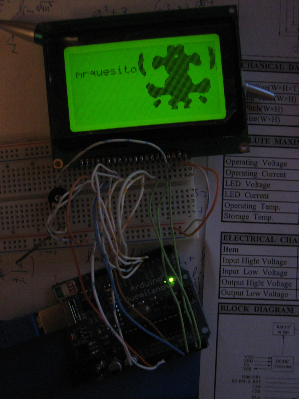

Right now, I'm making a project involving a ks0108 display where saving up is really important. Since I wanted to use a 328, and still use some pins, I've set up an ATMEGA8 (7.somthing Kb of free space) on a breadboard, and uploaded to it a simple code with the library and a serial communicacion protocol, to interface with the Duemilanove (the one that makes all the calculus and reads the sensors).
It works great, at this very moment I'm looking at it, and it's displaying a real-time sinus wave generated by the own ATMEGA8, so so far it doesn't seem to be too slow.

Sure! Here you are some fresh pictures (I took them this morning):
The first one is the Atmega8 attached to the GLCD, the next is the same, but with the Duemilanove (working as a power supply), and the last one shows how using the 2009 as GLCD "driver" makes pins disappear.
It's quite straightforward to do this: burn bootloader into atmega8, upload the sketch using the FTDI chip, wire up, and see how the sine is generated smiley-grin

Actually, so far only the atmega8 has code in it. The Duemilanove board just provides power. Here you are the code in the atmega:
