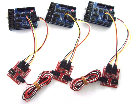

The actual processor used for industrial automation is not really the issue, it's all the things around it, networking, power reliability, external interfaces, etc etc.  I've used or been around dozens of different computers and PLC's used in automating IBM Chip fabs. There was resistance to bringing in Non-IBM Processors (Like DEC and SUN). I remember filling out the great form" Request for Foreign Processor in IBM"  smiley
And then there was resistance to using PC's in factory automation.  The IBM Industrial Computer line finally settled that issue.
Certainly any important automation job can done in an X86 environment with almost the same basic code environment as Arduino. I see Arduinos more as peripheral processors in specific equipment and areas. But they are adequate in non-real-time automation like home automation.
My Son designs complex data handling and logging equipment for the Wind Energy industry. His latest designs have 2 or 3 ATMEL processors combined. Written in C++.  (http://nrgsystems.com
A lot of moderately complex automation systems could be built with a few Arduinos on an RS-485 network sort of like this:
Anyway, let's keep in touch on this stuff.....

That networking of Arduino's is very interesting. As far as using Arduino's for industrial automation is very possible and highly probable I would agree, its merely acceptance as mentioned that will be a stumbling block since many factories also strive to standardize on say Allen Bradley only, or Siemens for example like my previous manager - Siemens only thank you very much.  smiley
