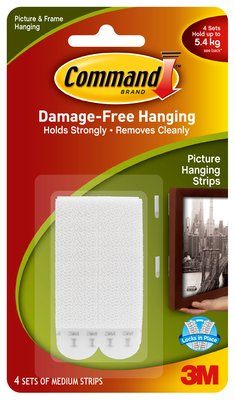

Lefty,
Thanks! Forgot to mention I got some 3M "velcro" stickers with adhesive backing. Will plan for next weekend. Too much exams to grade. With cold weathers like in my area, you gotta be able to remove these sensors at night. I don't have a garage, although with my arduino spending I could rent 2-3 garages :) You just have to stick to what's more important!  :smiley-mr-green:

Who's talking now lefty? XD
Front side:
Back side:
Original box:
