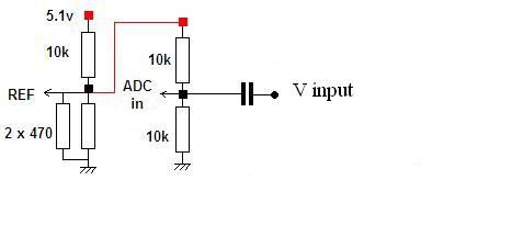

chrichri101
Good day
I am having a couple of challenges with this design.
1: I had issues with the coil/cap matching, but finally managed to get a combination that yielded a 32V p-p signal.
2. I then enable debug mode so that i can get detailed info via serial, and this is where my problems are now.
2.1 I am unable to get a valid reading, here is my debug info Some bits masked with "?" to anonymize data
got buf num: 0
1/16/29/5/5/4/5/6/29/5/5/5/4/6/6/24/5/5/5/4/6/6/15/6/6/6/6/6/
5/5/5/5/5/4/5/5/5/5/5/4/5/6/6/6/5/6/9/5/5/5/5/5/6/6/5/6/6/5/
4/5/5/5/5/6/6/6/5/6/5/5/5/4/5/5/6/5/6/6/6/9/5/5/5/4/6/6/6/6/
5/10/4/5/5/5/5/6/6/6/5/6/5/5/4/5/5/5/6/6/6/6/5/5/5/5/4/5/5/6/
6/5/6/6/9/5/5/5/5/5/6/6/6/6/5/4/5/5/5/5/5/6/6/5/6/6/6/6/6/5/
6/5/5/5/4/5/5/5/5/4/5/5/5/6/5/6/6/6/6/6/5/6/6/5/5/5/5/5/4/6/
6/6/5/6/9/5/5/5/5/5/6/5/6/6/6/5/4/5/5/5/5/6/6/5/6/6/5/5/5/4/
5/5/5/5/4/5/5/5/6/5/6/6/6/6/6/5/6/6/5/5/5/5/5/4/6/5/6/6/6/5/
5/5/5/5/5/5/6/5/6/6/6/5/4/5/5/5/5/4/5/5/5/5/5/5/6/6/6/6/5/4/
5/4/5/5/5/5/5/4/5/5/5/5/5/6/6/6/6/5/6/6/6/6/5/5/5/5/4/5/5/5/
5/4/5/5/5/6/6/6/5/6/6/6/6/6/5/5/5/5/5/5/5/5/6/6/6/6/5/4/5/5/
5/5/4/5/5/5/5/4/6/6/6/6/5/10/4/5/5/5/5/6/6/5/6/6/5/5/4/5/5/5/
6/6/6/6/5/6/6/6/6/5/5/5/5/5/5/4/6/6/6/5/6/10/4/5/5/5/5/4/5/5/
5/5/4/5/5/5/5/5/4/5/5/5/5/5/4/6/6/6/6/6/5/6/6/6/6/6/5/6/6/6/
5/5/5/5/4/5/6/6/5/6/6/5/5/5/5/5/4/6/5/6/6/6/5/5/5/5/5/5/5/6/
5/6/6/5/6/4/5/5/5/5/5/6/6/6/6/5/5/4/5/5/5/5/6/6/6/6/5/5/5/4/
5/5/5/6/6/6/5/6/5/5/5/4/5/5/6/6/6/6/6/5/6/6/6/5/9/5/5/5/5/4/
5/5/5/5/4/6/6/6/6/6/5/5/4/5/5/5/5/6/5/6/6/6/5/5/4/5/5/5/6/6/
6/5/6/5/5/5/4/5/5/6/5/6/6/6/5/5/5/4/5/5/6/6/5/6/6/5/5/5/5/5/
4/5/6/6/6/6/5/5/5/5/5/5/5/5/6/6/6/6/5/4/5/5/5/5/5/6/6/6/6/5/
5/4/5/5/5/5/6/6/6/6/5/5/5/4/5/5/5/6/6/6/5/6/6/6/6/6/5/5/5/5/
5/4/5/5/5/5/4/5/5/6/6/5/6/6/6/6/6/5/6/6/4/5/5/5/5/5/6/6/6/5/
6/5/4/5/5/5/5/6/5/6/6/6/5/5/4/5/5/5/6/6/6/5/6/5/5/5/4/5/5/5/
5/4/5/5/5/6/5/6/6/6/6/6/5/6/6/5/5/5/5/4/5/5/6/6/6/6/5/5/5/5/
5/5/5/5/6/6/6/6/5/4/5/5/5/4/5/5/5/5/5/4/6/6/6/6/5/10/4/5/5/
5/5/6/6/6/5/6/5/5/4/5/5/5/6/6/6/6/5/6/6/6/6/5/5/5/5/5/5/4/5/
5/5/5/4/5/6/6/6/5/6/6/6/6/6/6/5/5/4/5/5/5/5/6/5/6/6/6/5/5/4/
5/5/5/5/4/5/5/5/5/5/6/6/6/6/6/5/6/6/6/5/5/5/5/4/5/5/5/5/4/5/
5/5/6/6/6/6/5/6/6/6/6/5/5/5/5/5/5/5/6/5/6/6/6/5/4/5/5/5/5/4/
5/5/5/5/5/5/6/6/6/6/5/5/4/5/5/5/5/6/6/5/6/6/5/5/4/5/5/5/6/6/
6/5/6/6/6/6/6/5/5/5/5/5/4/5/6/6/5/6/6/5/5/5/5/5/4/5/5/5/5/4/
5/5/5/5/5/5/4/5/5/5/5/4/5////raw data
got a valid prefix, processing data buffer...
****got bad bit pattern in buffer, count: 0, value: 0
0/101/101/101/101/0/0/1/101/101/101/101/0/1/1/101/101/101/101/
0/1/1/101/1/1/1/1/1/1/1/1/1/1/0/0/0/0/0/0/0/0/1/1/1/1/1/
101/101/101/101/101/101/1/1/1/1/1/1/0/0/0/0/0/1/1/1/1/1/1/1/1/
0/0/0/1/1/1/1/1/101/101/101/101/0/1/1/1/1/1/101/0/0/0/0/0/1/1/
1/1/1/1/1/0/0/0/0/1/1/1/1/1/1/1/1/0/0/0/1/1/1/1/1/101/101/101/
101/101/101/1/1/1/1/1/0/0/0/0/0/0/1/1/1/1/1/1/1/1/1/1/1/1/1/0/
0/0/0/0/0/0/0/0/1/1/1/1/1/1/1/1/1/1/1/1/1/1/1/0/1/1/1/1/1/101/
101/101/101/101/101/1/1/1/1/1/1/0/0/0/0/0/1/1/1/1/1/1/1/1/0/0/
0/0/0/0/0/0/0/1/1/1/1/1/1/1/1/1/1/1/1/1/1/1/0/1/1/1/1/1/1/1/1/
1/1/1/1/1/1/1/1/1/1/0/0/0/0/0/0/0/0/0/0/0/0/1/1/1/1/1/?/?/?/?/
0/0/0/0/0/0/0/0/1/1/1/1/1/1/1/1/1/1/1/1/1/0/0/0/0/0/0/0/0/0/1/
1/1/1/1/1/1/1/1/1/1/1/1/1/1/1/1/1/1/1/1/1/0/0/0/0/0/0/0/0/0/0/
0/1/1/1/1/1/101/0/0/0/0/0/1/1/1/1/1/1/1/0/0/0/0/1/1/1/1/1/1/1/
1/1/1/1/1/1/1/1/0/1/1/1/1/1/101/0/0/0/0/0/0/0/0/0/0/0/0/0/0/0/
0/0/0/0/0/0/0/0/1/1/1/1/1/1/1/1/1/1/1/1/1/1/1/1/1/1/1/0/0/1/1/
1/1/1/1/1/1/1/1/0/1/1/1/1/1/1/1/1/1/1/1/1/1/1/1/1/1/1/0/0/0/0/
0/0/1/1/1/1/1/1/0/0/0/0/0/1/1/1/1/1/1/1/0/0/0/0/1/1/1/1/1/1/1/
1/0/0/0/1/1/1/1/1/1/1/1/1/1/101/101/101/101/101/0/0/0/0/0/0/1/
1/1/1/1/1/1/0/0/0/0/0/1/1/1/1/1/1/1/0/0/0/0/1/1/1/1/1/1/1/1/0/
0/0/1/1/1/1/1/1/1/1/0/0/0/1/1/1/1/1/1/1/1/1/1/0/0/1/1/1/1/1/1/
1/1/1/1/1/1/1/1/1/1/1/0/0/0/0/0/0/1/1/1/1/1/1/0/0/0/0/0/1/1/1/
1/1/1/1/0/0/0/0/1/1/1/1/1/1/1/1/1/1/1/1/1/1/0/0/0/0/0/0/0/0/1/
1/1/1/1/1/1/1/1/1/1/0/0/0/0/0/0/1/1/1/1/1/1/0/0/0/0/0/1/1/1/1/
1/1/1/0/0/0/0/1/1/1/1/1/1/1/1/0/0/0/0/0/0/0/0/0/1/1/1/1/1/1/1/
1/1/1/1/1/1/1/0/0/0/1/1/1/1/1/1/1/1/1/1/1/1/1/1/1/1/1/0/0/0/0/
0/0/0/0/0/0/0/1/1/1/1/1/101/0/0/0/0/0/1/1/1/1/1/1/1/0/0/0/0/1/
1/1/1/1/1/1/1/1/1/1/1/1/1/1/0/0/0/0/0/0/0/1/1/1/1/1/1/1/1/1/1/
1/1/0/0/0/0/0/1/1/1/1/1/1/1/0/0/0/0/0/0/0/0/0/0/0/1/1/1/1/1/1/
1/1/1/1/1/1/1/0/0/0/0/0/0/0/0/0/1/1/1/1/1/1/1/1/1/1/1/1/1/1/1/
1/1/1/1/1/1/1/0/0/0/0/0/0/0/0/0/0/0/0/1/1/1/1/1/1/0/0/0/0/0/1/
1/1/1/1/1/1/0/0/0/0/1/1/1/1/1/1/1/1/1/1/1/1/1/1/0/0/1/1/1/1/1/
1/1/1/1/1/0/0/0/0/0/0/0/0/0/0/0/0/0/0/0/0/0/0/0////
buffer stats: zeroes:86/ones:355/prevs:544/errs:14
I know for a fact that i am reading the right type of rfid tag.
Attached is also some photos of scope readings for data as it goes in on the Arduino pin
Any suggestions/recommendations on what might be wrong??

Ok I manage to get my design working.
Firstly my digitized data posted in my prv post was completely incorrect. I managed to fix my circuit and unfortunately had to completely change the code from the interrupt driven counter to a pulse length loop. once working, I also modified the circuit and code and now I am able to detect and read FSK, ASK and PSK tags.
The code is not optimal yet, and still needs tweaking but at present I can decode all the tags I have. I did a complete write up on my project site, I have included example scope signals, my code and my circuit.
http://www.gizmolab.co.za/universal-rfid-reader/
