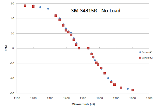

I am new to arduino but I'm planning to build a small cart also.  I recently purchased a number of Spring RC servos, including two of the SM-S4315R high torque continuous rotation servos.  I calibrated each of the servos manually using the writeMicroseconds command from the servo library.
Plug random numbers between ~540 to ~2400 into writeMicroseconds() and then count the number of revolutions in 60 seconds for each number you plug in.  If you graph this data you will see that you can correlate writeMicroseconds() values to specific values of RPM.
Code:
#include <Servo.h>
Servo myServo;  // create servo object to control a servo
  myServo.attach(9);  // attaches the servo on pin 9 to the servo object
  myServo.writeMicroseconds(1288);
Note that if you change the voltage to the servos, this may change the curve slightly.
At ~5.3 V, here is the curve I got for my two servos:
Notice from the graph that there is a 'dead band' in the center where I will get 0 RPM over a range of writeMicroseconds() values.  I will probably want to write software that collapses this zone.  Otherwise, I could end up writing a program that expects the cart to move very slowly, yet the cart doesn't move at all.
Also notice in the graph that there is a range in which the Microseconds and the RPM are pretty much linear, but at high and low RPMs the graph starts to curve and levels off at the max/min RPM.
Logged
