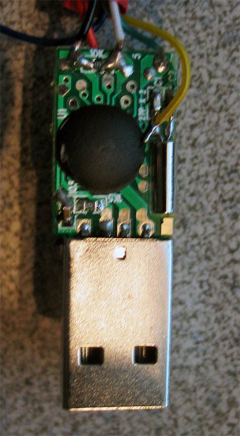

ok.. so I took apart my cable.. I have 4 wires soldered to the prolific clone...
doesnt look any of the pics..so I couldnt follow them exactly..
WIRE   --  PCB -- ATMEL
BLACK -- GND --  GND on breadboard
WHITE --  RX  --  TX on chip
GREEN --  TX -- RX on chip
RED  -- 5v -- v++ rail on breadboard

Well I didnt give up guys...
and I got it working..
I re-checked the 4 wires I 'do' have on there.. and they were correct..
so I read some posts.. and started to give it some more 'tries' and adjusting my 'manual' reset button timing..and I got it working!
So thanks to everyone who replied..
my only/last question is.. (two parter) =)
a.) how can I go about finding the RESET pad to solder a wire to? and when it just goes to pin1 right?  same as the manual reset button?
b.) what would a possible 6th wire be used for?? (I see some have 6?)
Thanks

Yeah I read that article.. (even linked to it in the first post) smiley-wink
however.. my PCB does NOT look the same..and in fact has a big blob o resin over the chip..and I dont see any other chips..or chip numbers to verify anything.
is it possible that these boards just dont HAVE a reset??

The DTR will be in there, under the resin, the chances you can find it and tap into it without destroying the whole thing are nil.  If its just the reset thats the problem, you can press the manual reset at the right time and it should go.  I find hitting reset after clicking upload at the point it reports the sketch size works for me.

@xl97
I have read your post, but I didn't really looked at these links, anyway your Nokia cable may look like this one:
As you know there are so many kinds of those cables and I have also seen same hack of this kind cable with a
on board chip too. Some of them has labeled (TX, RX, DTR,...) on board but I guess yours has no labels!
We could much better see it, when you have upload a picture of your cable (board)

Yeah its more like one..
on underside has labels/numbers of all pads at edge of PCB.. and a 5v pad label
on top side it has a 'few' labels.  one or two numbers a few via.. and thats about it.
Im not dead in the water.. I can manually reset using the button..but would be a 'full' solution if I didnt have to . smiley
I'll try and get some pics up tonight when I get home from work.
Thanks   smiley

ok..as promised some pics.. crappy ones..but pica none the less.. smiley-wink
hopefully someone can help me not only identify this pcb..but more so..the DTR/RESET pad to jumper off of.
Thanks
any help is appreciated.
