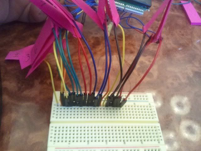

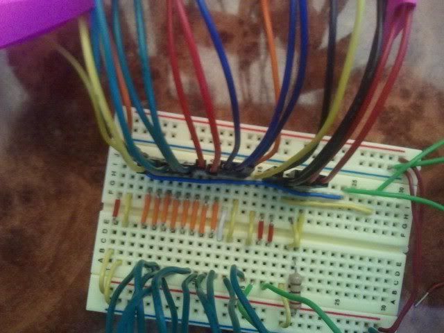

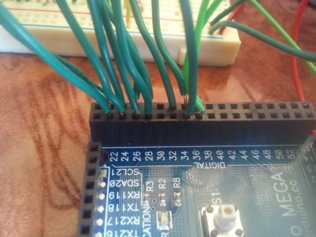

Here are some pics of the set up now:
Thanks for the help.
-Martin
bperrybap
The first/original wiring sounded like it was working with the only issue being the chip select
pins swapped.
Can you get back to that wiring?
The diags is reporting an error that still looks like some sort of wiring issue.
You've got a lot of wires there.
Why so many?
It looks like you have small blue wires connecting to the wires
going into to the breadboard.
How are those attached to each other?
Twisting them together is very likely to create intermittent connections that
won't work reliably.
(Recently I saw another person chase errors related to this for a week or more.)
How about the wires going to the glcd?
Do you have any photos of the wires going to the glcd?
A wide shot that shows everything might help.
It can be helpful especially if it can show all the wires including the potentiometer.
--- bill
