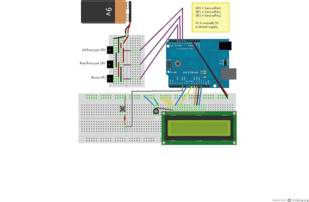

I've been working on this project for a very short time and I can see the half way point of the whole project. Here is a recap
I'm replacing my automotive gauge sensors with an Arduino board I have an LCD and some sensors for testing / POC
I've tested the sensors and the LCD are basically working the way I want,  I can fine tune later.
What I need to do is be able to switch between the sensors (sensorPin0, sensorPin1, sensorPin2) and display the results on the LCD. I've tested all of the sketches individually and their good enough for POC. Below is my sad attempt to join the 3 sketches.
Now I want to toggle between the sensors and display on the LCD.   At the moment a DPDT push button will have to do as my rotary encoder hasn't arrived yet.
All I want to do is hit the button 5 times (somewhat quickly) and it displays the status of the next sensor on the LCD, so it will just keep toggling through the sensors / display endlessly
I've included my code and a Fritzing any suggestions would be appreciated. I've looked at the Menu Library but it seems it might be a little much for what I'm wanting to do. I may be wrong. Any examples I can dissect would help, I like learning this stuff but chasing rabbits gets old quick!

Suggestion:  have an integer variable called something like current_sensor that is set by some code that interprets switch presses.  Also the code to drive the lcd can then use this variable to determine which sensor to display.  In effect you have split the problem into two simpler problems.
Arrays are very useful once you start numbering the sensors BTW.

Interrupts?   No I'm just suggesting splitting the problem into (A) detecting button presses and updating the variable (this can be tested in its own right and you will learn by doing)  and (B) using an integer variable to selecting what you display - again you can test this separately.

ok I got a button push counter integrated into the sketch. It now triggers pin 13 (an LED / event) when the button is pushed 4 times (very slowly  smiley-confuse got to figure that out also ). I also think i've got 'most' of an integer variable setup right for each of the sensors but I think I'm missing a little bit.
Basically I need the LED / event to trigger switching to the next menu item and when it comes to the end, it goes to the beginning. Tie the event (LED high) to switch to one of the sensorVar (I think)
Here's my code as it sits now. Of course I'm open to all suggestions.

Code:
int sensorVal0 = 0;
int sensorVal1 = 1;
int sensorVal2 = 2;
Strange initial values...
Code:
    sensorVal0 = analogRead(sensorPin0); // read Analog0 pin sensor oil and mapping it to a value
Why are you reading a value in setup()? You don't use that value.
Code:
   // sensorVal0 = analogRead(sensorPin0); // read Analog0 pin sensor oil and mapping it to a value
   // sensorVal1 = analogRead(sensorPin1); // read Analog1 pin sensor fuel and mapping it to a value
   // sensorVal2 = analogRead(sensorPin2); // read Analog2 pin sensor boost and mapping it to a value
What are the curly braces for?
Code:
    lbg.drawValue( analogRead(sensorPin0), 1024);  // -- Analog 0 sensor pin for Oil sender, link for the LCDBarGraph library)
    delay(500);          // ~ 2Hz display is fast enough
And these?
Quote
It now triggers pin 13 (an LED / event) when the button is pushed 4 times (very slowly  got to figure that out also ).
With three 1/2 second delays, you will only read the switch state every 1.5+ seconds. It will take 6+ seconds to read 4 switch presses. Is that the "very slowly" you are referring to?

Ok so I cleaned up the code. Still not able to figure out how to trigger an input

int sensorVal0 = 0;
int sensorVal1 = 0;
int sensorVal2 = 0;
void setup() // (setup and starting  the activated Arduino ports, runs once)
    // OIL PRESSURE SENDER SETUP
    lcd.begin(16, 2); // lcd rows and columns
    lcd.setCursor(0, 1); // set cursor to second row, first column
    lcd.print("Oil Pressure"); // title of sorts
   // delay(500);          // ~ 2Hz display is fast enough
    // FUEL PRESSURE SENDER SETUP
    lcd.print("Fuel Pressure"); // title of sorts
    //   PRESSURE SENDER SETUP
    lcd.print("Boost"); // title of sorts
    sensorVal2 = analogRead(sensorPin2); // read Analog1 pin sensor fuel and mapping it to a value
  // lcd.begin(16, 2); // lcd rows and columns (will be removed once switching is resolved)
  // lcd.setCursor(0, 1); // set cursor to second row, first column  (will be removed once switching is resolved)
  // lcd.print("XYZ oil 0"); // title of sorts  (will be removed once switching is resolved)
  // delay(500); // time to display title (will be removed once switching is resolved)
  // initialize the button pin as a input:
  pinMode(buttonPin, INPUT);
  // initialize the LED as an output:
  pinMode(ledPin, OUTPUT);
  // initialize serial communication:
void loop() // (stuff that is constantly looped or monitored)
  //  BUTTON COUNTS
  buttonState = digitalRead(buttonPin);  // read the pushbutton input pin:
  if (buttonState != lastButtonState) { // compare the buttonState to its previous state
    if (buttonState == HIGH) { // if the state has changed, increment the counter
                              // if the current state is HIGH then the button
                              // went from off to on:
      buttonPushCounter++;
      Serial.println("on");
      Serial.print("number of button pushes:  ");
      Serial.println(buttonPushCounter, DEC);
    else {
      // if the current state is LOW then the button
      // went from on to off:
       Serial.println("off");
    lastButtonState = buttonState; // save the current state as the last state, for next time through the loop
  if (buttonPushCounter % 4 == 0) { // turns on the LED every four button pushes by
    digitalWrite(ledPin, HIGH);     // checking the modulo of the button push counter.
  } else {                          // the modulo function gives you the remainder of
   digitalWrite(ledPin, LOW);       // the division of two numbers:
  // BAR GRAPH RESULTS FOR EACH SENSOR
    lbg.drawValue( analogRead(sensorPin1), 1024);  // -- Analog 1 sensor pin for Fuel sender, link for the LCDBarGraph library)
    lbg.drawValue( analogRead(sensorPin2), 1024);  // -- Analog 2 sensor pin for Boost MAP sender, link for the LCDBarGraph library)
    delay(200);          // ~ 2Hz display is fast enough

Ha ok
If I press the button 4 times a LED lights (pin 13) I need find a sample or get some help on how to convert the event (LED light on when button is pressed 4 times) to display the next sensorpin

No not quite. I want 4 presses display oil ...4 presses display fuel... 4 presses display boost etc.

Can I put a switch (state) in void setup?

Yes, but you probably don't need to. In PaulS' example, state would be zero at that point, so there would be no need to test what it was - you already know. Furthermore, it'll call loop very shortly afterwards, state will still be zero & the switch statement there will take care of putting something on the display.
BTW, out of curiosity, why do you want four button presses from the user to invoke a display change?

I was looking for a rotary encoder and was about to order one when my GF though away an old USB Mini laptop mouse. Well the scroll wheel is a cheap little switch. I've never seen one before but each click is an open and close.
it the perfect wheel color and size for my project, It's simple to code for, the mounting is very simple, and best of all its free.
I want to scroll the wheel half a turn which counts to be about 5 open and closings of the switch. I've got some debouncing to do, but getting the stupid state thing to work is killing me.
this is my code so far. Its ugly but im trying, But I'm tempted to pull out the checkbook and see is someone wants to make a few bucks to finish the code. UUUGGGHHH
