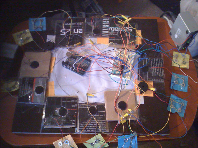

Hello all,
 a little background, I am trying to build a midi percussion instrument useing piezo sensors  [that expands upon Todbot's mididrumkit http://todbot.com/arduino/sketches/midi_drum_kit/ by employing the Fluidforms Cassius punching bag's http://www.arduino.cc/playground/Projects/ArduinoUsers&sa=U&ei=EHeoTZ_5JMK60QHBnv35CA&ved=0CBQQFjAC&sig2=dRV4dGbMY9LtUx7ylfMGGw&usg=AFQjCNEa5PVsvBFmui1eRMli_iT241942g code, another geat project that was very helpfull is the midifootstep http://www.thebox.myzen.co.uk/Hardware/MIDI_Footsteps.html and less I forget my homies at ITP Physical Computing http://itp.nyu.edu/physcomp/]. In my draft below sensorID are notes middle C and up one and one half octaves, where value [j] is the velocity byte i.e. the last byte of the  'note on'/'note off' command to be sent. I haven't tested the sketch yet. I could really use a little guidance as the syntax is still very new to me. I may have overlooked or left something out so if I've made an error or you see a way I can build/optimise a working sketch your insight would be greatly appreciated.

Am I on the right track here, and can anyone help with
Quote
// replace note with array[i,j]
