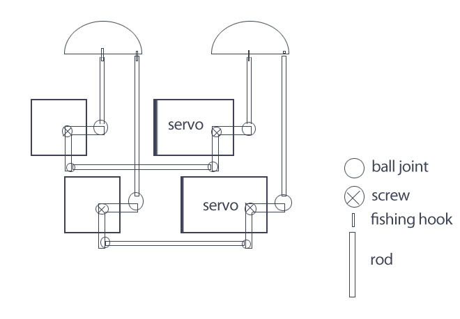

I'm an illustration student planning on making a very slightly animatronic silicone doll for my degree show. Now, I thought I had enough time to teach myself enough Arduino to accomplish what I set out to do, but it's now 17 days until hand ins and because of some technical and post-office related hitches with my moulding process I haven't got round to writing the program for the animatronics.
What I originally wanted to do was have a head up/down mechanism, eyes l/r, up/down and ears forward and back but I quickly realised this was unrealistic (and expensive) and I quickly reduced it down to the eyes simply moving left, right, up and down. Here was my hardware layout for the eye movement, based on one of WilletFX's designs.
I have made the rig and tested it with a servo sweep - it works well! It's just my basic, basic knowledge of arduino hardware means I am constantly terrified I might explode my servos because I didn't put in the right resistor or something. It takes me a lot of brain power to get my head around engineering and right now I'm focussing it all on getting my portfolio polished, blah blah...
I do however know how to connect up one servo, so I've reduced the movement yet again to just... left and right. (I got a strange mini breadboard with my starter kit and I'm not sure how it works :S) What I've come here to ask is if anyone would be willing to write a few short and simple lines of code to move the servo randomly (and slowly) to mimic eye movement. I can do the wiring for this one, messily but well enough for the exhibition.
If anyone wants to tackle two servos and try and help me set up the wiring I would be forever appreciative. I have a lot of electrical gubbins I bought for the project but no brain behind it really! I know this is a lot to ask because it would be so much simpler in real life but I learn quickly and I am willing and able to accept any advice or abuse you have for me!

So what exactly do you want it to do - move imitating human eye movement?
If you can be a bit more detailed about what you want then the code is simple enough.

Yep exactly. I was going to code it so the servo moved a small amount and stayed there for a few seconds, moved to another random position for a second or two then move again, sort of basic REM. The idea is that the creature will be crouched at ground level looking up at the audience at the exhibition, so it would be good if it was almost looking from person to person. Of course it won't actually recognise that there's someone there but if luck strikes it might look straight at them which would cause a great reaction. smiley-grin
I had planned for it to be on a loop with a mains power supply with an idea of having a random number generator in the code so it never did the same pattern of positions twice but I don't know how feasible that is, if it's simply a sequence of positions over and over again then that's fine too, so long as it's not immediately noticeable.

Sounds simple enough - random number generator should be easy enough too.

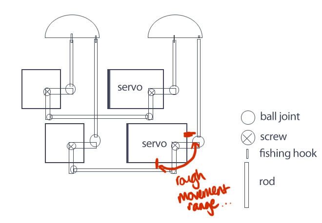

So what are the servo limits? is 0-180 min to max movement or is it going to break something if it goes to 0 or 180? (in either direction).
If it's on the floor does that mean that it wants to be looking up more than down? to look at people?

Yeah I had a rough code working well, I just don't have time to smooth out the kinks.
I might also need a little bit of help with the wiring.
Hmm I think it's less than 180, while the rods swivel with the ball-joints and the fishing swivels aide movement I think 0-180 might break them. I think when the ball-joint touches the edge of the servo is probably the limit, I couldn't tell you the specific numbers though (how helpful!) However on Monday if I have code to work with I'll set it up, take some videos and have a play with it all.
As for being on the ground if you're going to us both servos rather than just the L/R then keeping the eyes more up than down would be good, but if it's just one servo with L/R movement I'll make sure they're looking up when I fit them in the skull.

Well like I say, make the limit values close to 90 (middle of the servo's movement say 70 and 90) and test that - then see what happens - if you then make one of the limits larger (further off 90) then you will be able to see if the values need switching.
Then simply fiddle with the values until it acts as desired.
