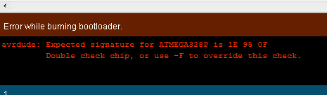

BTW, out of stupidity, I bought a couple of the atmega1284-PU chips instead of the
atmega1284P-PU chips, and to burn the bootloader, I found I had to track down the
avrdude.conf file and change to the chip-signature to that for the 1284. Then, it
burned the bootloader ok using the ArduinoISP sketch from a UNO chip.
However, to download sketches into the 1284 bootloader chip using the IDE, I then
had to change avrdude.conf back to the original 1284P chip-signature. Interesting.
That's because the Arduino bootloader doesn't use the hardware signature in its sketch-loading
protocol, it uses the signature bytes compiled into the bootloader binary when it was compiled.
If you use ICSP to burn a bootloader you have to match the hardware signature...

The 2 devices have a different signature. I added the 328 to my Arduino and AVRDude files so that makes it easier to burn a bootloader. Once the bootloader is loaded they are interchangeable in the Uno board so the Uno config is sufficient to program them. I have a couple 328's that I have installed the bootloader on. they have all been in my arduino board and also in a wireless breadboard that has a MAX232 for a serial interface. Once the bootloader is loaded they all function the same with the ArduinoIDE.

Hello,
I cannot burn the UNO bootloader in my ATmega328 for the signature reason. It says
will you kindly tell me the procedure to fix the issue?
Thanks

Hi
Here is a fix:
http://www.instructables.com/id/Bootload-an-ATmega328/step6/
/Mikael

Hi, How do you add the atmega 328 to your arduino and avrdude ? I always need to change the signature when bootloading atmega 328.
