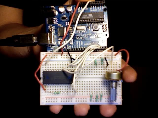

Thing with arduino is that lets a lot of people with no previous involvement with electrons play with wires but it can get very frustrating when you don't know what you are doing as is my case. So please can anyone post some pictures of how to connect the 14067B to the arduino? newbies will apreciate that.
Here's how i connected it, for some reason is not working:
I just have red, black and white wire and light is not good so it may not be clear, tomorrow I will take another one with better lighting.
As Massimo posted I've connected the pin 24 of the 14067B to 5V, a green 10K resistor from 5V to pin 15 (what's the difrence between brown and green resistors?) and digital pins 2 to 5 of my arduino to pins 10, 11, 13, 14 of the 14067.
Is that configuration right?

If i understood right i have to send the binary number for the multiplexer port i want to read to the multiplexer pins labeled A, B, C and D but that makes me wonder:
how does the multiplexer tells when I finish sending a port number and started sending another? does that has to do with the INHIBIT pin? the resistor from 5V to pin 13 has to be a brown one? what am I doing wrong?
Hope someone can help me to work it out..

well now it's working, I've just disconected the inhibit pin (number 13) from the resistor that went to 5V, but unless I am reading port 0 it behaves erratically. shall I leave it disconnected?
