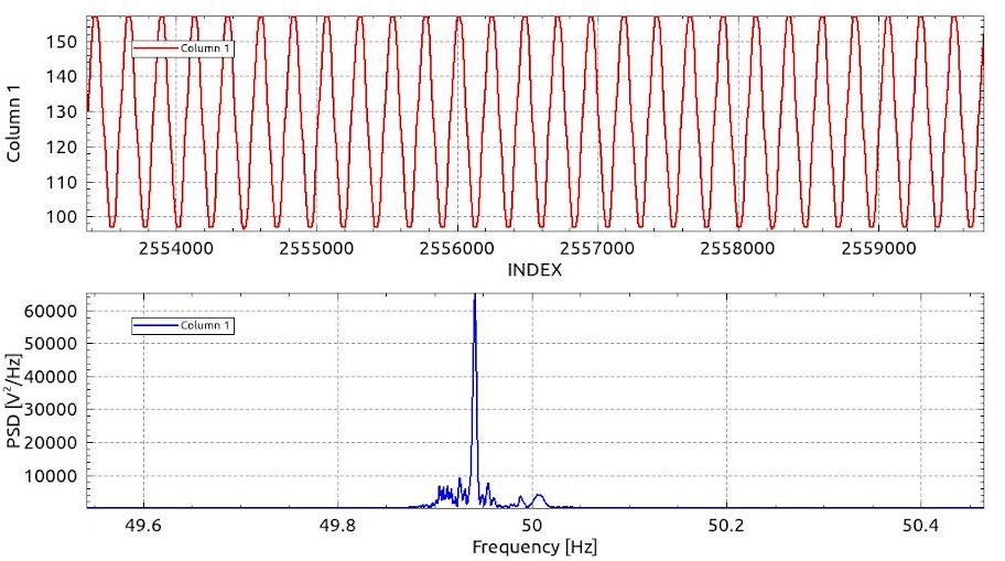

I've been working a little more on this.
Now with the help of a small python script, I'm plotting in "real time" into KST with a frecuency of 11.7 kHz (85.02 us)!!! The ADC is in 8 bits mode.
The example is the signal acquired from a trafo connected to the AC:

Original post (in Spanish) => http://arduino.cc/forum/index.php/topic,68855.30.html
