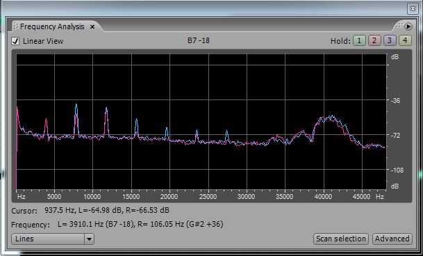

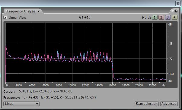

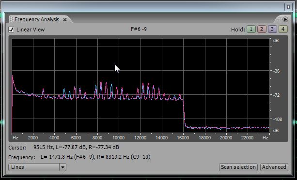

As for the frequency, well it's not that simple, analyzing it it with the Audition Frequency Analyzer visualizes much better what I hear:
15/255pwm:
35/255pwm:
47/255pwm:
I ultimately perceive a pitch of about 3200Hz which seems to increase with increasing the pwm speed as well become more quiet which can also be seen on the screenshots.

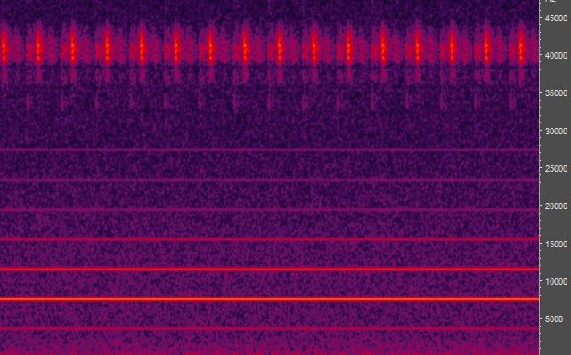

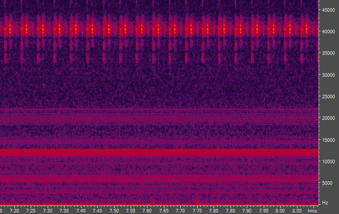

Just thought I should check how it looks at 3000Hz PWM frequency.
Looks less noisy, but louder and higher pitched:
64/255pwm at 3900Hz (recorded to wav instead of mp3 thus the increased range on the high end)
Interestingly enough the lamp would no longer light up at 16/255pwm which it did at the lower pwm frequency.
Looking at the Spectrum analyzer shows the annoyance quite beautifully:
64/255pwm at 3900Hz
The audible noises are clearly 7800Hz and 11700Hz! They are all multiples of the pwm frequency! Beautiful.
Any theories why exactly this is the case?
I have great hopes for 31khz now!
35/255pwm at 488Hz for comparison
And now of course I realize that what I see here is that its all multiples of 488Hz...
It seems like the pitch did not change at all with the increased pwm frequency but it got louder, so my hope to shift the noise into the ultrasound spectrum is diminishing. It kind of concentrated the noise frequencies resulting in a higher amplitude. However, because the noises are all multiples of the pwm frequency I am hoping that the lowest will be 31khz with the mosfet driver. We shall see when what happens when I get it. Will also play around with some ceramic caps when I get some time.
