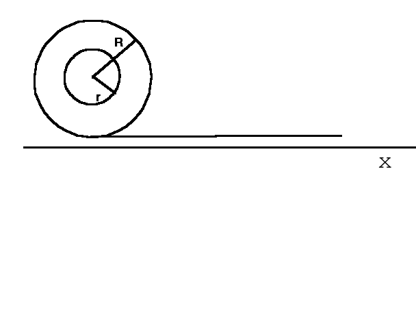

I need a motor that can control speed very precisely under a moderate but fairly constant torque, to within a couple percent at least. To give you an idea what torque is needed, it's going to be used to pull photographic film through a 35mm camera as the rest of the camera rotates (for panoramas). The motor needs to be accurately controllable between 5RPM and 70RPM.
Steppers are easy to implement but I'm worried that common 1.8*/200 per revolution steppers like this (http://www.pololu.com/catalog/product/1207) will have too 'course' of stepping action and cause vibration or 'notchy' film motion. I could use a stepper and gear it down several times using rubber belts and pulleys, but I'm having a hard time finding rubber belts and pulleys online. Does anyone have any input on how smooth these things turn against a load at say 50rpm? I could add a flywheel I guess.
I could also use a servomotor, but ready-made high-torque servos are hard to find. I could use a regular gear motor like this (http://www.pololu.com/catalog/product/992) and somehow put an encoder on it to make it a servo, but I have tried that before and it was hard to control except for in a narrow speed range.

It's a continuous-motion setup. I have already built a prototype using a 60rpm gear motor and achieved encouraging result. My prototype operated in completely 'open loop' or 'dead reckoning' mode which quickly lost sync. If I could find a way to add an encoder to my current gearmotor I could reuse it, but that will be hard, I think. I would rather buy a motor with an encoder on it. I want controllability from 5 to 70rpm, and the ability to get feedback from the motor, at least, so that I can servo-lock it to the camera motion. A stepper would be way easier, but I don't think it would be smooth enough.
Quote
I can't imagine why you wouldn't directly couple the film sprockets to the pan rotation.
Do you mean with hardware gearing? There are a couple reasons. One, the sync between the two speeds needs to be matched, and I don't think you could build a mechanical linkage that can be 'trimmed' enough. You would have to get lucky and have the two shaft speeds end up integer multiples of each other. Second, it's desirable to have the thing work with multiple lenses--much easier with software. Third, the way I have it set up now, the speed of the winding motor actually has to change as the camera pans because the effective diameter of the takeup spool increases as film winds on. This is not a problem in software as my prototype has proven.

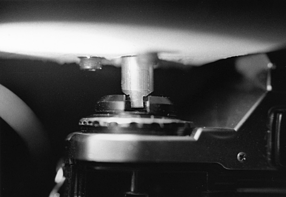

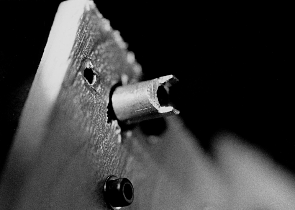

the camera has a mechanism designed specifically to draw the film with the correct tension and at a steady rate
The camera has no such mechanism. The sprocket drives in 35mm cameras, and in movie cameras for that matter, are not designed to smoothly pull the film through the gate at a steady rate. They are designed to advance the film to the next frame. I'm not shooting frames, so the current mechanism is worthless to me. Modifying the camera to allow use of the sprocket with continuous film motion would require me to completely gut the internal workings of the camera and make a new drive interface with the film drive sprocket. I might as well make my own camera. It's easier to simply couple to the film rewind spool. This way, I don't even have to modify the camera! The only disadvantage is that the diameter of the spool increases as film winds on, but that is easy to fix in software. The rewind spool speed simply decreases linearly with platform rotation; finding the correct fudge factor is easy. In fact my back-of-the-envelope calculations, measuring the film thickness with calipers, were pretty much right on.
See pictures below.
Schematic of the rewind spool and film:
Picture of the mask in the film gate:
Picture of the coupling I made for the rewind knob:
Picture of the above coupling meshing with the rewind spool:
This works fine; the only problem is the open-loop control with the plain gearmotor, which actually works but only in a fiddly way. I've already taken pictures with this setup folks. I already found the motor I need at Pololu. I'll just buy one of these:
http://www.pololu.com/catalog/product/1446
and once I get it reconfigured with that motor motor I'll be rockin'. It's not really a servo motor because I'll have to implement my own PID/servo loop in software, but it's basically what I was trying to do last time with making my own encoder...but hopefully this one will work.
